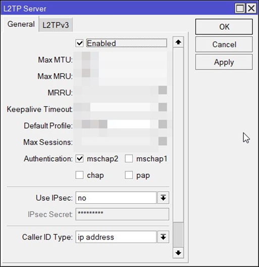

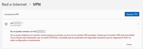

I have set up an L2TP/IPsec VPN connection, and when trying to establish it from my company's computer, I encounter the following error:
"The remote connection could not be established because an error occurred in the tested VPN tunnels. The VPN server may be inaccessible. If the connection is attempting to use an L2TP/IPsec tunnel, the necessary security parameters for IPsec negotiation may not be configured correctly."
The VPN configuration seems correct, as I have tested it on several personal devices (Windows11), and it works fine.
However, the error consistently appears on the computers within my company. I have tried it on different models we have (HP, Lenovo), running both Windows 11 and Windows 10.
I have conducted the following checks without success:
Verified the Windows patches KB5009566 for Windows 11 and KB5009543 for Windows 10. They are not installed.
Enabled the "Microsoft CHAP version 2 (MS-CHAP v2)" protocol in the VPN connection.
Activated the "Enable LCP extension" option within the "PPP Configuration" in the VPN settings.
Restarted and set the "IPsec Policy Agent and IKE" and "AuthIP IPsec Keying Modules" services to start automatically.
Can anyone help me find a solution to this issue?vpn_error
