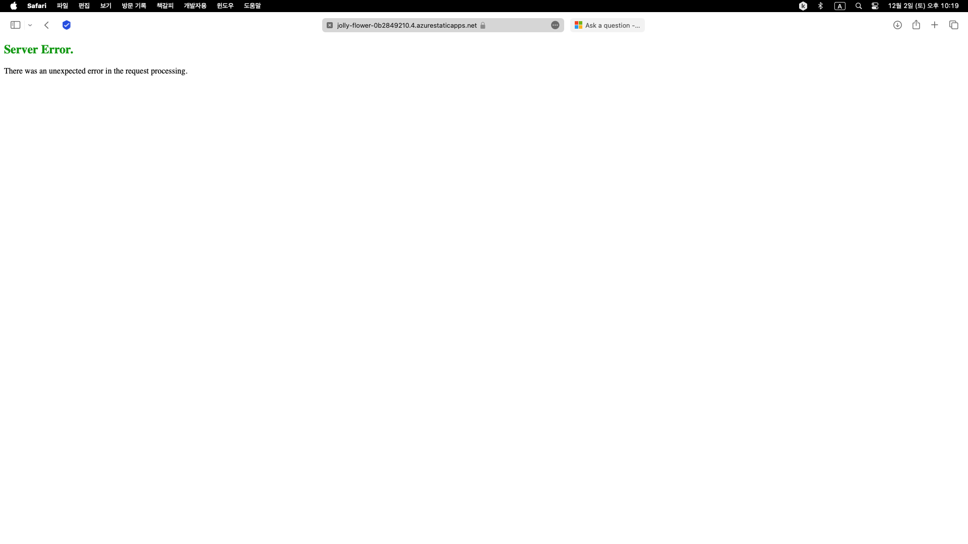

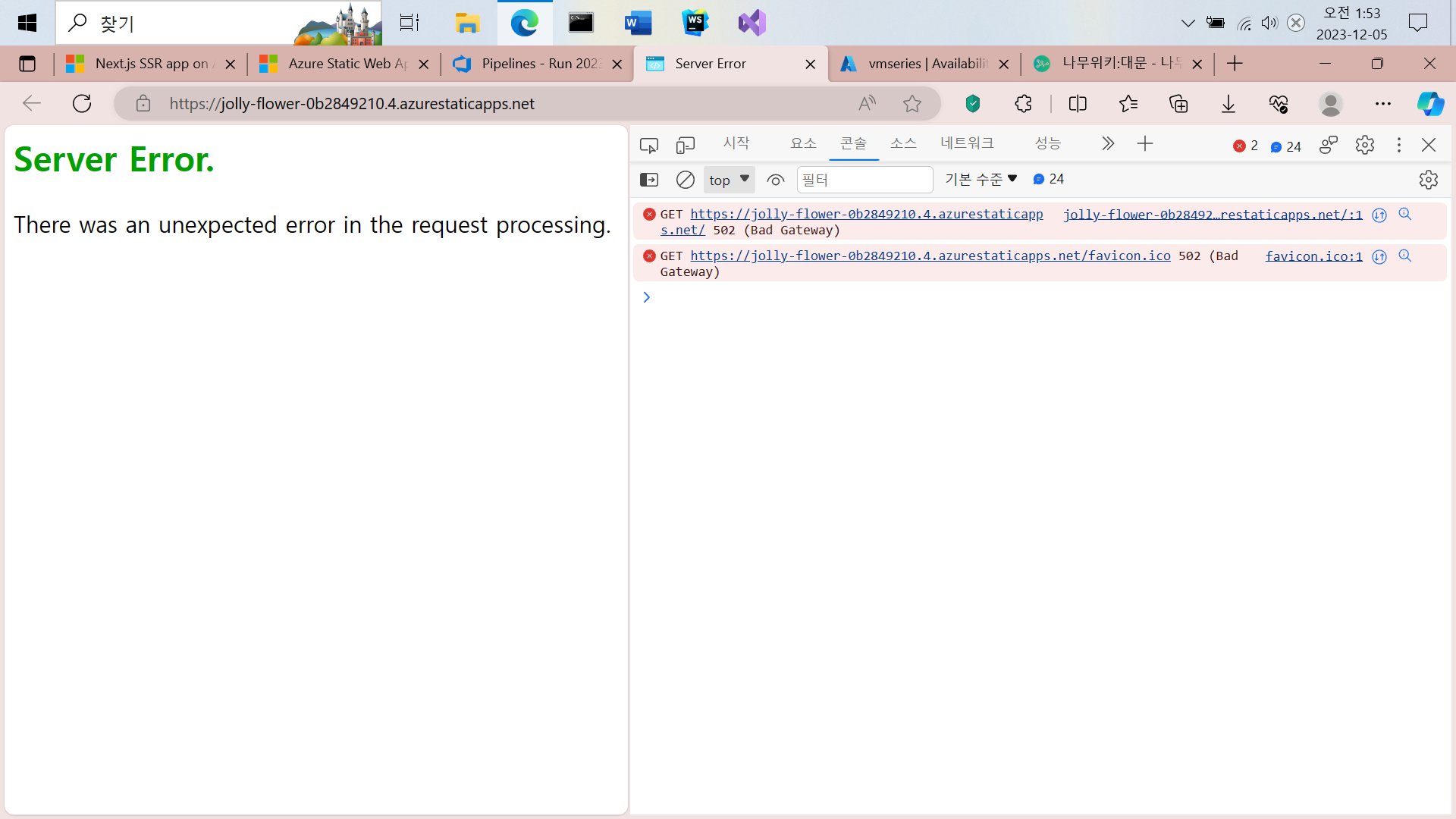

I depolyed a simple Next.js SSR app to Azure Static Web Apps via Azure Pipelines. It deployed with no error, but app throws "Server Error”.
스크린샷 2023-12-02 오후 10.19.59
I didn’t installed other packages via yarn and using default Azure pipeline YAML file. The only thing which is not basic on my app is Yarn; I’m using ver 4.0.2 - so I had to use node:18. I don't use app router. I use good-ol' pages router. I tried everything I can do and nothing worked.
This is my app: https://jolly-flower-0b2849210.4.azurestaticapps.net

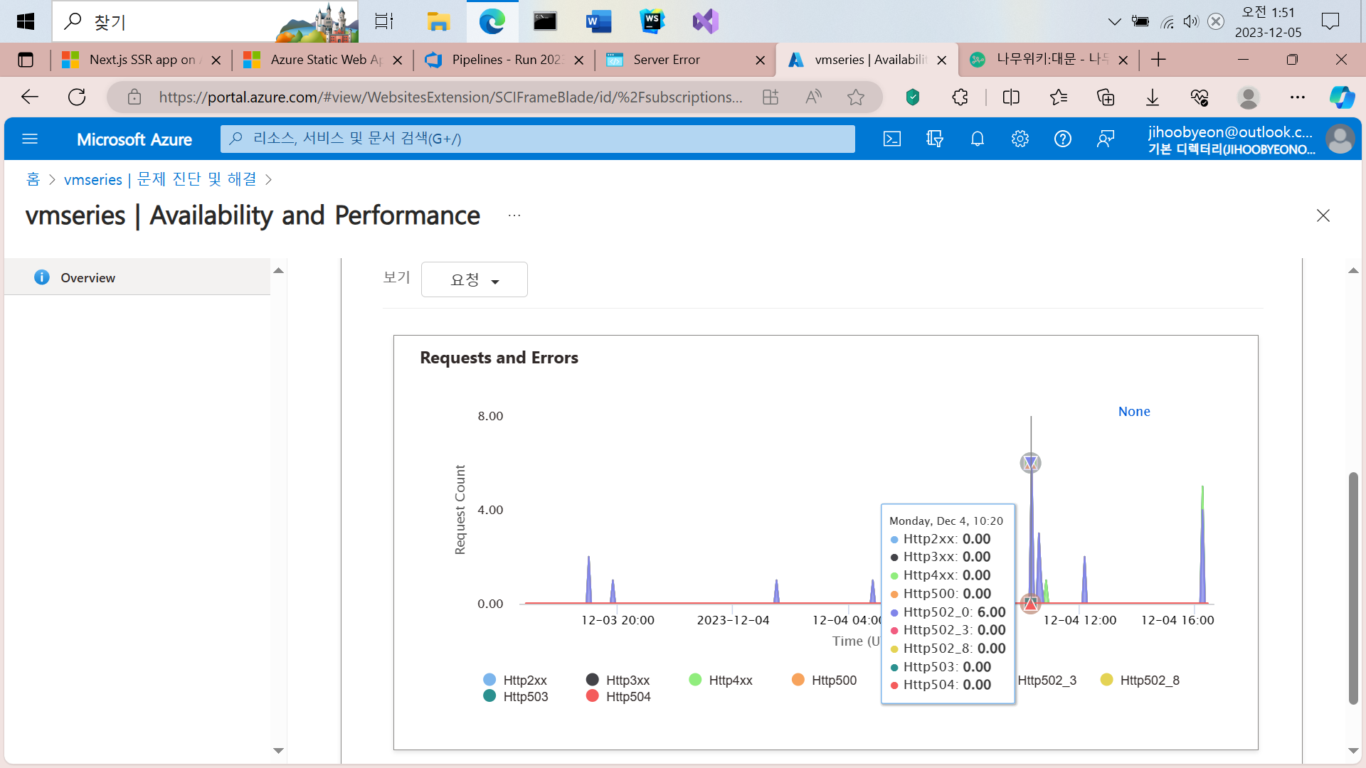

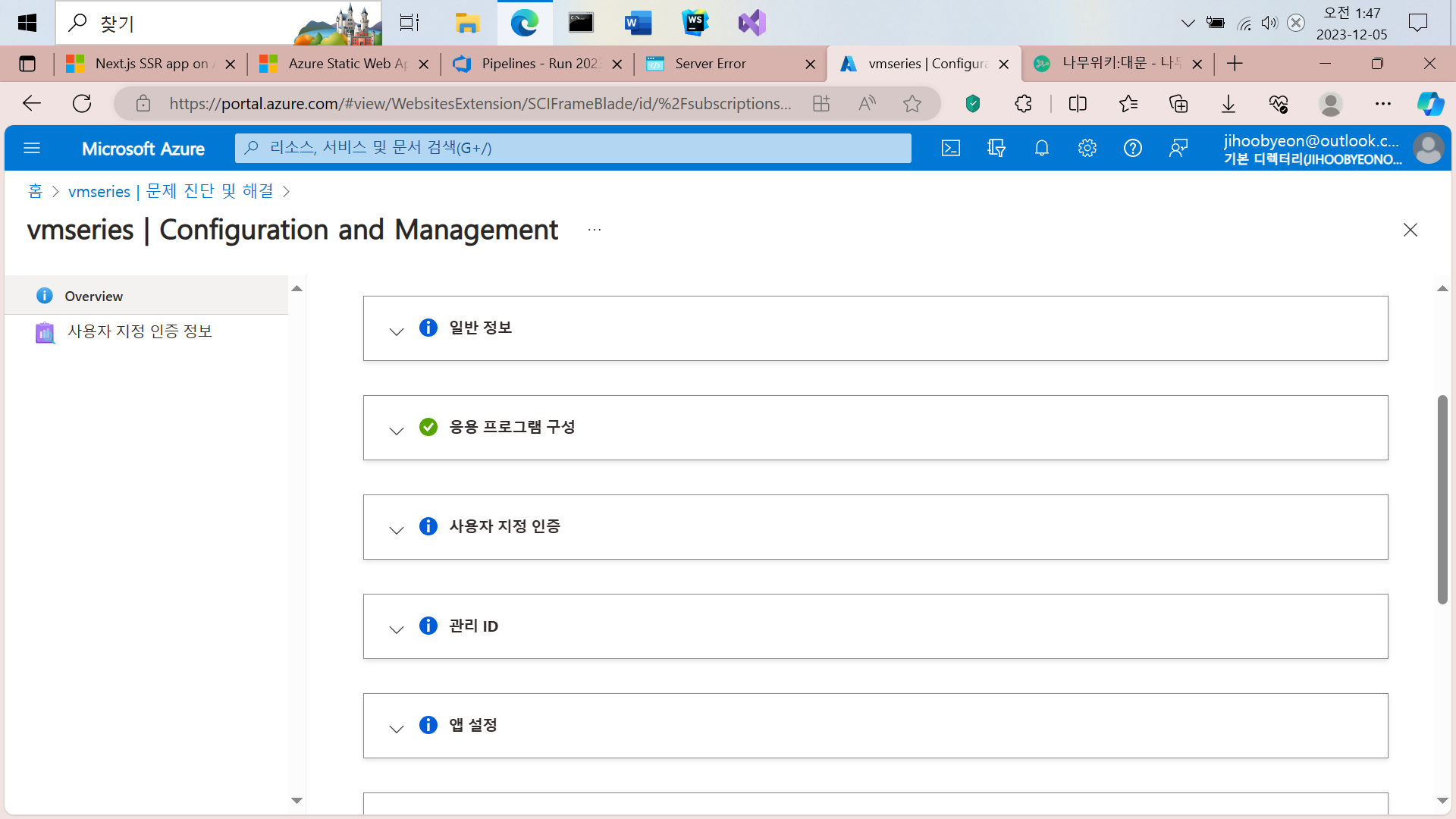

    1.    You may always leverage Azure Static Web Apps diagnostics from Azure Portal> Navigate to your App Service app in the Azure Portal.
    In the left navigation, click on Diagnose and solve problems - Review and run - “Configuration and Management”
    -Azure Static Web Apps diagnostics overview
