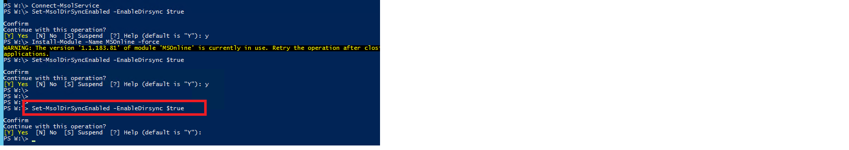

I am migrating from Exchange 2013 to MS Business Basic. It is small organzation running only single server Win2012R2 AD+Exchange combined and one other server Win2016.

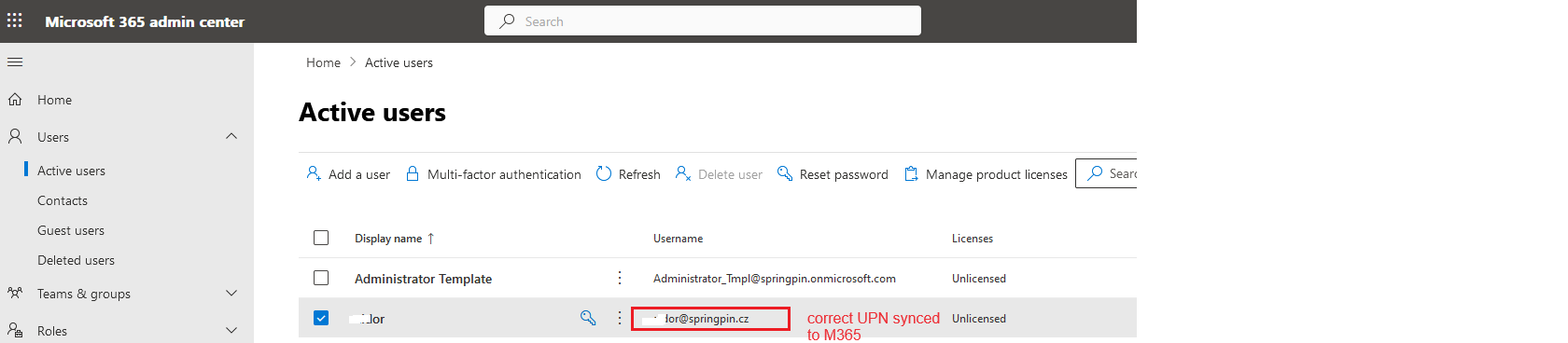

I have added UPN identical with default email domain to the local AD before running HCW first time.
I am getting error HCW8001 even after I did Set-MsolDirSyncEnabled -EnableDirsync $true.
I've had run the HCW on Exchange server (that is Windows 2012R2) and get the above error in "configuring" phase and no AADSync was installed. I believe it is normally installed during HCW process or am I wrong?

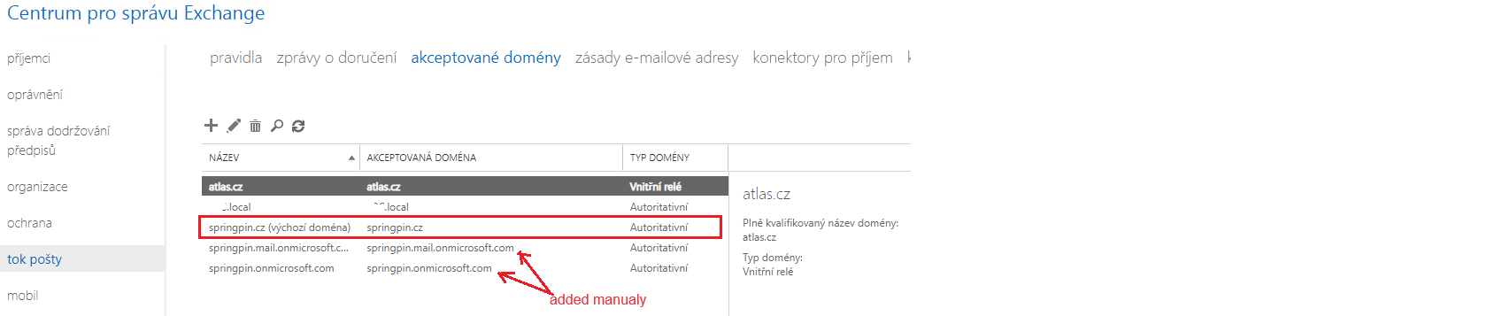

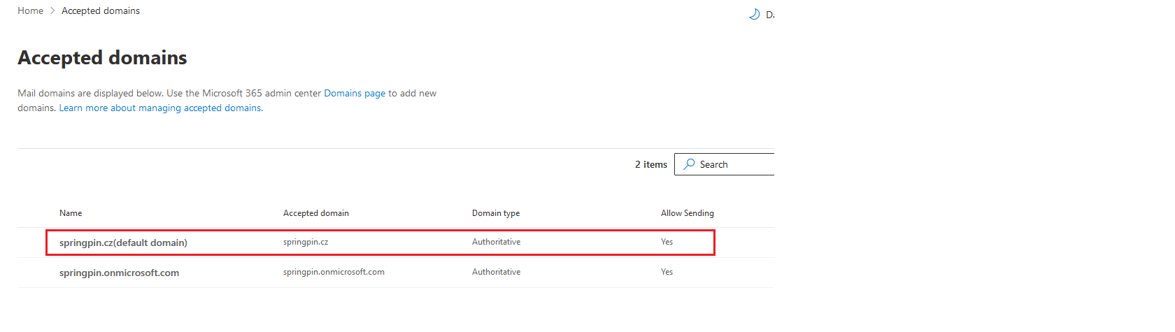

I found articles describing simillar problem, talking about AADSync creating domain "mail.onmicrosoft.com", so I decided to install AADSync by hand. It could not be installed on Exchange Server, because Win 2012R2, not supported by current version AADSync. I installed AADSync on the other server in domain, Win2016. AADSync is working, but domain mail.onmicrosoft.com was not created in the E365 accepted domains.

    You mentioned that you have already run the command Set-MsolDirSyncEnabled -EnableDirsync $true but still face the same error. I suggest you check if the accepted domain is associated with your on-premises Exchange server and Office 365 tenant. You can also refer to the prerequisites for deploying hybrid.
    It is worth noting that the domain “mail.onmicrosoft.com” is created by default when you set up directory synchronization using Azure AD Connect. It is used as a unique identifier for each user in Office 365.
    Besides, you can also try to use the following cmdlet to manually add the routing address for some user and then re-run the HCW to see if it can help:
    Set-AdUser username -Add @{ProxyAddresses=('smtp:******@contoso.mail.onmicrosoft.com')}

    I have opened MS Support case. The support engineer basicaly did the same procedure as me, many times before (download and run HCW) and this time it went through without error. He has run no script nor did any changes in the on-prem environment. Meaning, he has made some changes in the Tenant before calling me, but I don't know what it had been.
    I don't think it could be done by simple tenant's global admin anyway.
    After session, the .mail.onmicrosoft.com domain was present in the Exchange, I can't say if it had been there nefore HCW run or not.
