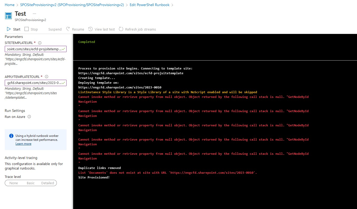

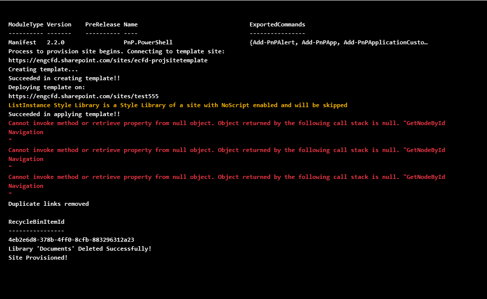

In testing the Runbook, all works fine. The script runs, the site template is copied and deployed to the new SharePoint site. (The GetNodeByID error is expected)

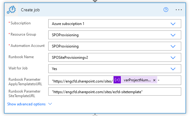

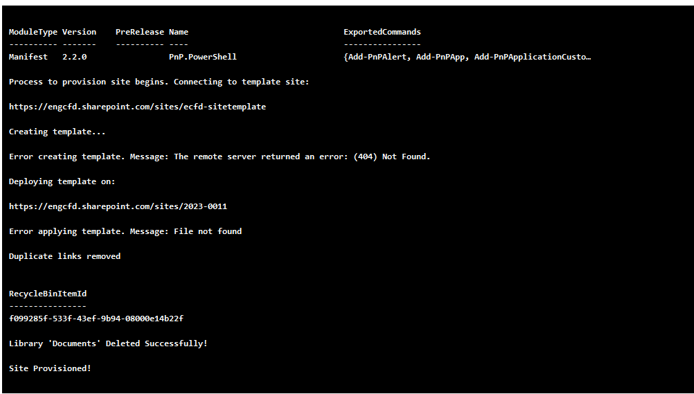

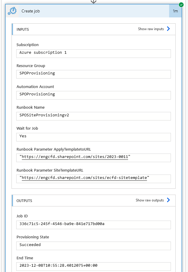

However, when the Azure Runbook is triggered via Power Automate the runbook fails, with an error when trying to create the template: The remote server returned an error: (404) Not Found.
And then an error when trying to Invoke the template: File not found
Rubook_viaFlow
I've rebuilt the runbook, deleted the Azure Job from Power Automate and re-connected it. Nothing seems to work. I have various runbooks which do the same thing on other tenants and this has never occurred. Can anyone help as to what may be be issue?
