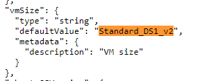

I am trying to provision an IoT Edge using the provided IoT Edge Azure Resource Manager template, in this template, by default the VM is AMD64 based OS architecture is getting deployed, if I do want to provision ARM64 OS based architecture IoT Edge VM for testing using the same ARM template, what should I need to change in the provided ARM template in the following link.

    Hi @Dhanavath Vishnu Greetings! Apologies for the delayed update on this. We have investigated further into this issue and observed that the template URI command is referring to edgeDeploy.json file
    Within the file, there is a section name osProfile where the OS configurations are set for the VM. Please refer the following link to find this section. This is the place where we are passing the packages that needs to be installed on the VM. You can try modifying this section of the deployment file and see if you can set up configurations for ARM64 OS.
    We are also checking on this issue internally and let you know if the product team has any recommendations for it.
