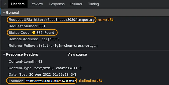

    HTTP 302 Found is a redirect response, usually means "Moved Temporarily". Use browser developer tools to inspect network requests, it can provide additional information about the redirect. Look for the "Location" header, which indicates the URL to which the request is redirected. The source is either in the web server settings or in the application itself, so no one knows but you.
