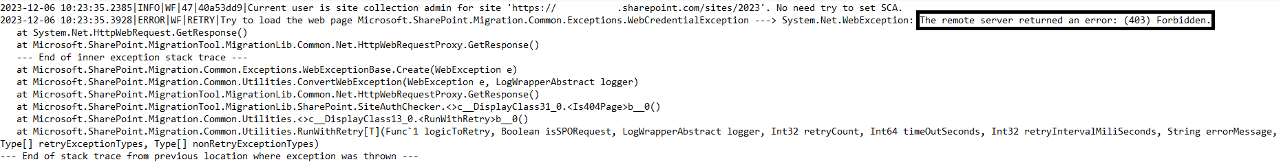

Hi All,
Got an issue when using the sharepoint migration tool to upload files and folders from a share/local drive.
It logs on ok, and goes through the whole process. Completes with a green ticket, but when I look on the site there is nothing there.
I have even tried uploading from the sharepoint admin page using the migration agent, and that also fails. I am definitely logging on with a global admin account that has owner permissions on the site
These are the errors that I see in the logs:
2023-12-05 15:03:40.5468|ERROR|WF|RETRY|Try to load the web page Microsoft.SharePoint.Migration.Common.Exceptions.WebCredentialException ---> System.Net.WebException: The remote server returned an error: (403) Forbidden.
   at System.Net.HttpWebRequest.GetResponse()
   at Microsoft.SharePoint.MigrationTool.MigrationLib.Common.Net.HttpWebRequestProxy.GetResponse()
   --- End of inner exception stack trace ---
   at Microsoft.SharePoint.Migration.Common.Exceptions.WebExceptionBase.Create(WebException e)
   at Microsoft.SharePoint.Migration.Common.Utilities.ConvertWebException(WebException e, LogWrapperAbstract logger)
   at Microsoft.SharePoint.MigrationTool.MigrationLib.SharePoint.SiteAuthChecker.<>c__DisplayClass31_0.<Is404Page>b__0()
   at Microsoft.SharePoint.Migration.Common.Utilities.<>c__DisplayClass13_0.<RunWithRetry>b__0()
   at Microsoft.SharePoint.Migration.Common.Utilities.RunWithRetry[T](Func`1 logicToRetry, Boolean isSPORequest, LogWrapperAbstract logger, Int32 retryCount, Int64 timeOutSeconds, Int32 retryIntervalMiliSeconds, String errorMessage, Type[] retryExceptionTypes, Type[] nonRetryExceptionTypes)
--- End of stack trace from previous location where exception was thrown ---
   at System.Runtime.ExceptionServices.ExceptionDispatchInfo.Throw()
   at Microsoft.SharePoint.Migration.Common.Utilities.RunWithRetry(Action logicToRetry, Boolean isSPORequest, LogWrapperAbstract logger, Int32 retryCount, String errorMessage, Type[] retryExceptionTypes, Type[] nonRetryExceptionTypes)
   at Microsoft.SharePoint.MigrationTool.MigrationLib.SharePoint.SiteAuthChecker.Is404Page(String pageUrl)
2023-12-05 15:03:40.5468|DEBUG|WF|RETRY|Exception did not match retry types Microsoft.SharePoint.Migration.Common.Exceptions.WebCredentialException
2023-12-05 15:03:40.5468|ERROR|WF|18|ad027a62|Web https://company.sharepoint.com/sites/itr does not returns 404 Microsoft.SharePoint.Migration.Common.Exceptions.WebCredentialException ---> System.Net.WebException: The remote server returned an error: (403) Forbidden.
2023-12-05 15:03:40.8570|INFO|WF|18|ad027a62|Current user is site collection admin for site 'https://company.sharepoint.com/sites/itr'. No need try to set SCA.
2023-12-05 15:03:40.8909|ERROR|WF|RETRY|Try to load the web page Microsoft.SharePoint.Migration.Common.Exceptions.WebCredentialException ---> System.Net.WebException: The remote server returned an error: (403) Forbidden.
2023-12-05 15:03:40.8909|DEBUG|WF|RETRY|Exception did not match retry types Microsoft.SharePoint.Migration.Common.Exceptions.WebCredentialException
2023-12-05 15:03:40.8909|ERROR|WF|18|ad027a62|Web https://company.sharepoint.com/sites/itr does not returns 404 Microsoft.SharePoint.Migration.Common.Exceptions.WebCredentialException ---> System.Net.WebException: The remote server returned an error: (403) Forbidden.

    Hi @Jason P,
    The error message "The remote server returned an error: (403) Forbidden" in the logs doesn't affect the migration because I also found this error in my successful migration.
    You should ensure that the files are scanned, packaged, uploaded, and imported correctly. Go to the migration report, check summary reports like "ItemSummary.csv", "ScanSummary.csv" and so on.
    If the answer is helpful, please click "Accept as Answer" and kindly upvote it. If you have extra questions about this answer, please click "Comment".
