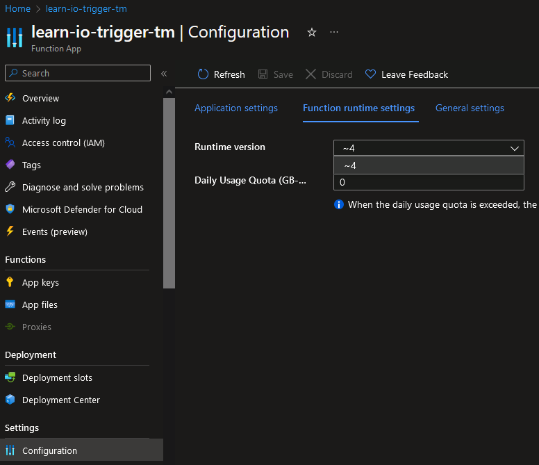

Saw multiple posts suggesting changing the function's runtime version from 4 to 2, but the drop down for that only gives me the option for version 4.
