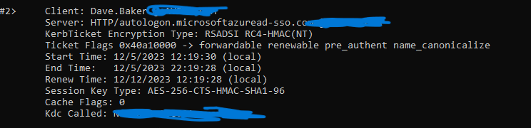

  1. Running klist after I have authenticated to Azure shows a kerberos ticket is issued from the azuresso domain, but there is no indication of a ticket being issues by the AZUREADSSOACC computer account. (see this excerpt: List the existing Kerberos tickets on the device by using the klist command from a command prompt. Ensure that the tickets issued for the AZUREADSSOACC computer account are present. Users' Kerberos tickets are typically valid for 10 hours. You might have different settings in Active Directory.)
kerberos
I've ran through the checklist and known issues on the MS KB and cannot see what is causing this failure. Help!
