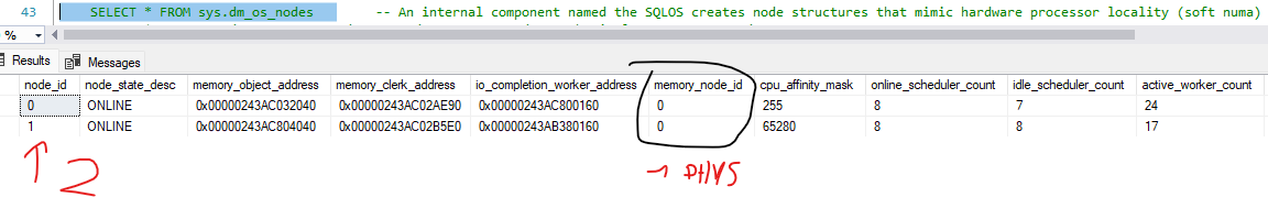

From SSMS seems a only NUMA node with 16 CPU (0-15)
but using t-sql, I see 2 nodes which refer to the same physical node(correct me if I'm wrong!)User's image
I also tried using a script that reported values that didn't match (https://github.com/MadeiraData/MadeiraToolbox/blob/master/Best%20Practices%20Checklists/MaxDOP_Configuration_Check.sql)
This gives me values that do not correspond to my situation, namely:
@NumaNodeCount: 1 (NO I GOT 2 NUMA from SSMS or is DMV the correct one?)
@LogicalProcessorPerNumaNodeCount: 16 (this is right/wrong depending on whether you interpret it from SSMS or from t-sql)
The only fixed point is that the server created the soft-NUMA by seeing the logs... the MS recommendation is clean on soft-NUMA (https://learn.microsoft.com/en-US/sql/database-engine/configure-windows/configure-the-max-degree-of-parallelism-server-configuration-option?view=sql-server-ver16):
"NUMA node in the above table refers to soft-NUMA nodes automatically created by SQL Server 2016 (13.x) and higher versions, or hardware-based NUMA nodes if soft-NUMA has been disabled."
In conclusion I would like to understand whether to consider 1 NUMA node or 2? In any case, whether it is 1 or 2, the maximum conceivable degree is always 8.

    On page 39 I found the answers I was looking for. There are soft-NUMA nodes (0 and 1) created by SQL Server and which were encountered by a HW with 4 sockets in my case. Since there are 16 logical cores, sql server created this new subdivision to better manage memory access. So in my end the answer was:
    • 0 and 1 are soft-NUMA;
    • these two must be evaluated to set the MAX degrees of parallelism (8)
    Of course this is an indicative value, some OLAP queries will go faster at 16 but the value 8 is fine as a general limit. So we need to think about the soft-NUMA created by sql server and the number of vCPUs/SOS Schedulers present in these.
    So...now that I am sure of how many soft-NUMAs there are, the tables shown in the document are clear:
    https://learn.microsoft.com/en-US/sql/database-engine/configure-windows/configure-the-max-degree-of-parallelism-server-configuration-option?view=sql-server-ver16, the table the values refer exclusively to soft-NUMA and nothing else for SQL 2019!
