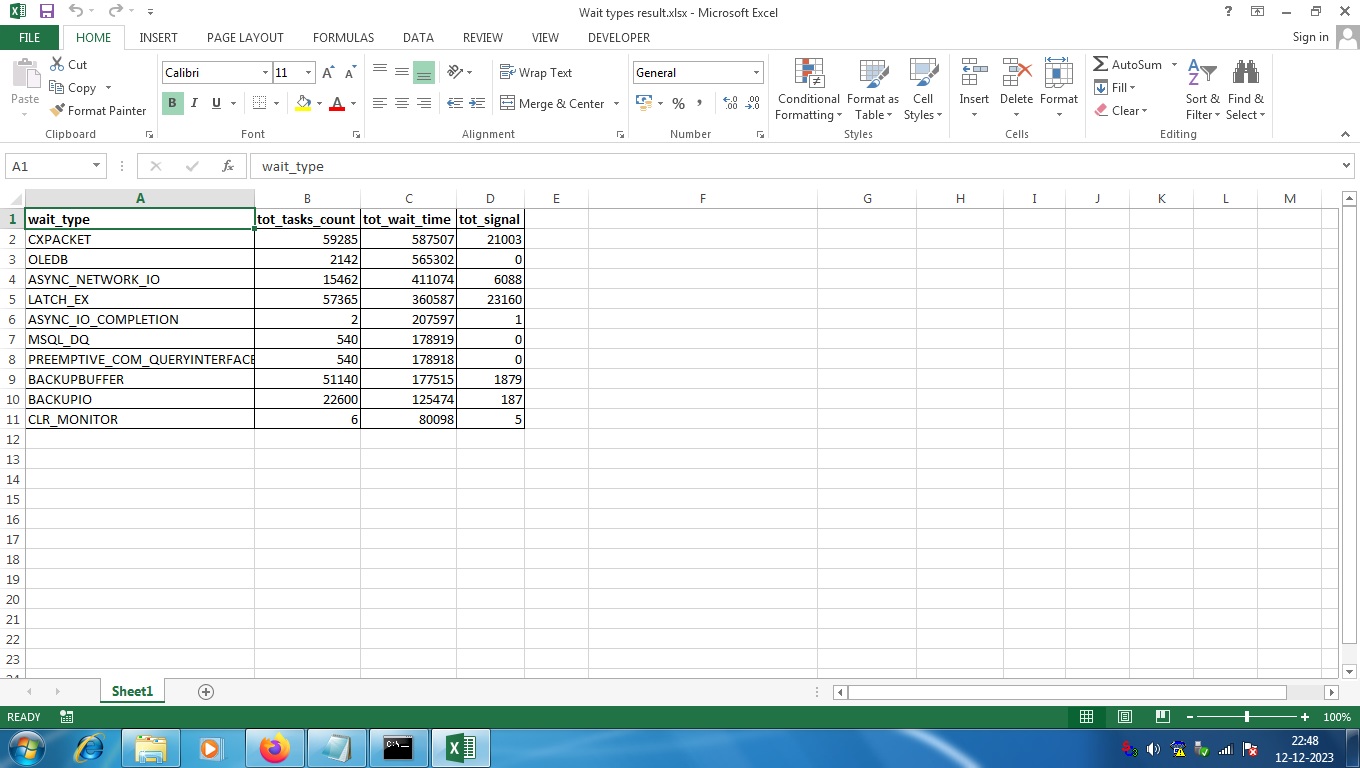

SLOWDOWN IN APPLICATION DURING SQL SERVER BACKUP.
DM 546 Reputation points
2023-12-07T17:47:10.3333333+00:00
We are noticing a major slow down in one of our applications when daily full backup runs; application comes to normal speed once it is over. There hasn't been major increase in data; happening from last couple of weeks. We tried to figure out any thing if not normal; but everything seems fine. That particular db size is 30 gb. Ram utilization grows to 90% of 64 gb during backup and that is a dedicated server for that app. Application also slows down during 2-3 jobs from last week.
Please suggest what else to check or to speed up backup process/speed up job.

  1. Erland Sommarskog 121.4K Reputation points MVP Volunteer Moderator
    2023-12-26T19:10:38.7033333+00:00
    It would have helped to see the numbers. But PAGEIOLATCH_SH, CXPACKET, WRITELOG and LATCH_EX sounds like regular application activity to me. The PREEMPTIVE waits on the other hand, could from from the backup. Then again, I don't know how you collected this information. Did you follow my instructions, or did you just take a snapshot of the DMV? Overall, I have made several comments and question, which you have left without notice. I maintain that 15 minutes to backup a 30 GB database an external SSD is really poor - or is that USB 2.0.
    As I said before, I think it is time for a major revision of both hardware and SQL Server version.

    I have found the following to be useful. SOmeone else posted something similar.
