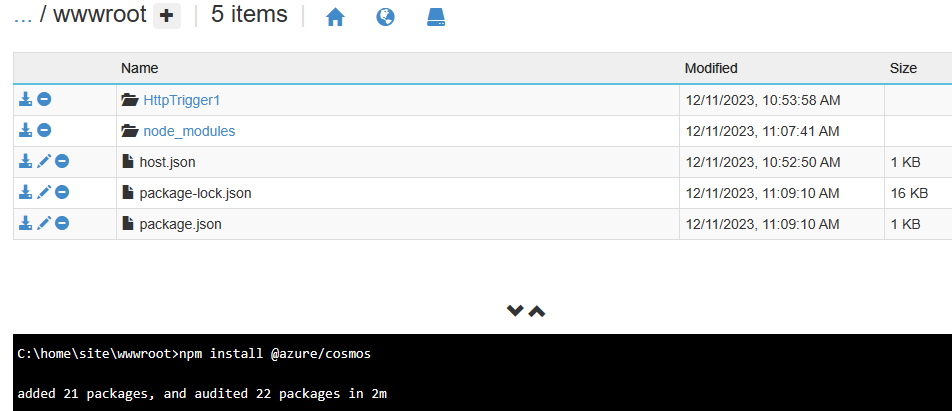

    From the description above, it appears that you would like to perform it via in-portal development. Here are the steps you can follow:
    1. Select Advanced Tools -> Go option in the azure portal to open Kudu console and then choose CMD from Debug console option at the top.
    2. Then navigate to C:\home\site\wwwroot directory and install https://www.npmjs.com/package/@azure/cosmos library with the below command (npm install @azure/cosmos):
    That should create package.json file which includes cosmos package with the latest supported version, and you can perform delete operation inside the function like below:
