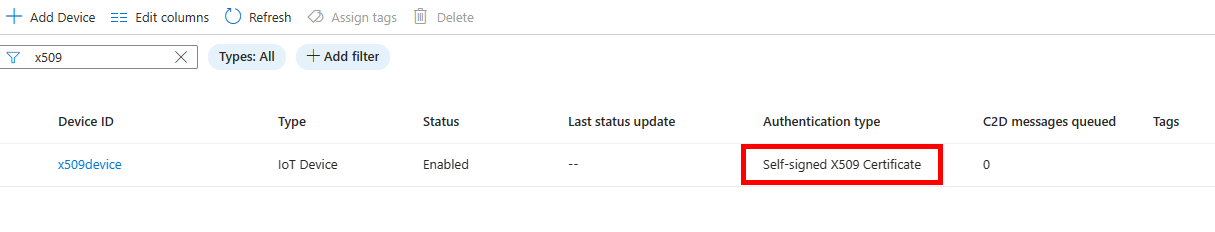

  1. LeelaRajeshSayana-MSFT 17,866 Reputation points Moderator
    2023-12-11T18:19:56.4333333+00:00
    Hi @Andrea Previtali Thank you for posting the question here. I have tested this behavior by Creating a test X509 self-signed certificate and registering a device on IoT Hub. I could see that the device created on the portal shows the authentication type as Self-signed X509 Certificate. Please refer the below image for reference.
    The issue you see could likely be an intermittent issue with the Azure portal. I appreciate it if you can test the behavior again and let us know if you see this to be consistent.
