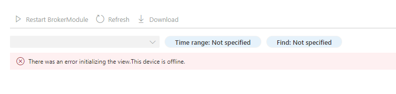

I am able to use the Azure IoT Edge Extension for Visual Studio Code to deploy to my device and the deployment succeeds. However, when I look at the modules in Docker Desktop, the edgeAgent and edgeHub modules resart every second or so. Below are some screenshots of what I can see inside the Azure portal.
deployment
device
troubleshooter
I believe that I have my custom module 'BrokerModule' figured out as it is running normally from what I can see in Docker Desktop. It is just the edgeAgent and edgeHub that are not behaving as intended. Please let me know if any more information is needed, any suggestions are welcome.
    I would like to clarify that your Module is down too. Without the Edge Agent and Edge Hub running, your module would not be able to connect to IoT Hub. You can see from the runtime status of IoT Edge device that all modules are reporting error and none of them are running.
    If the above information does not help you address the issue, kindly let us know the system configurations such as hosting machine OS type, it's version and the IoT edge device authentication type to help us better understand the issue. I would also like you to test and see if the Edge Agent module runs and could connect to IoT Hub when you remove the BrokerModule from the deployment.
