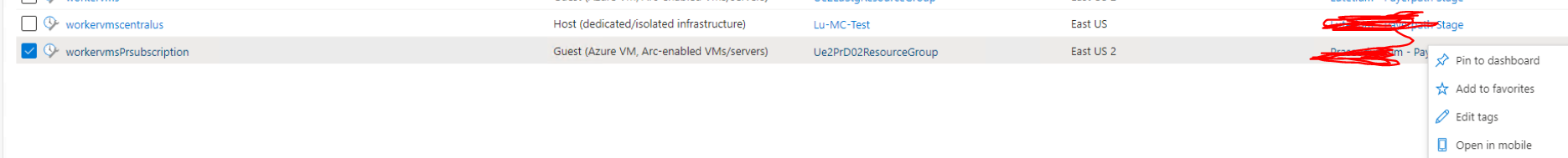

Not able to delete maintenance configuration and not found delete option
sns 9,246 Reputation points
2023-12-14T02:46:42.72+00:00
Please share me the if there is any azure cli/PowerShell commad to do so

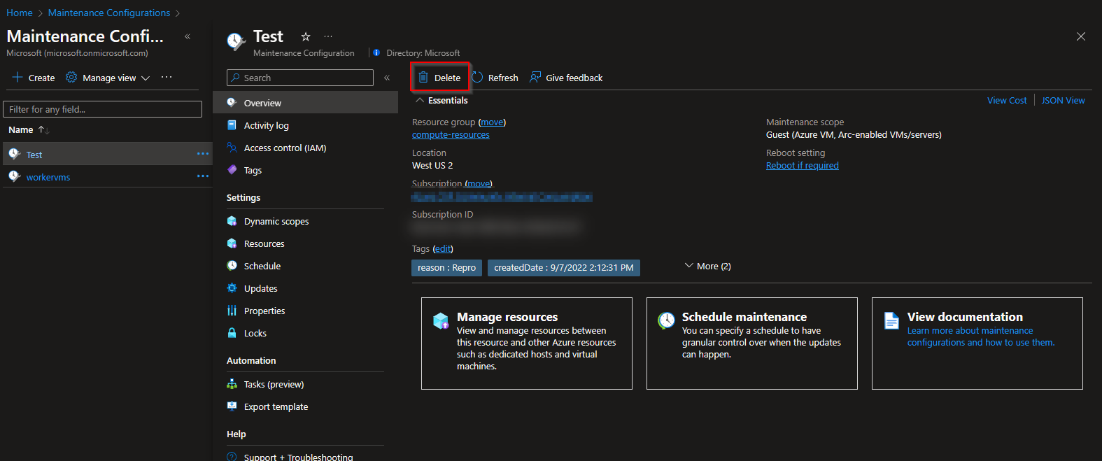

    @sns You can click the maintenance configuration and click on delete button as highlighted in below image. Kindly remove all the assignments before deleting the maintenance configuration.
    PowerShell command to remove maintenance configuration : Remove-AzMaintenanceConfiguration
