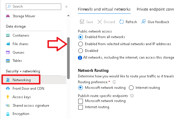

    If public network access is disabled in the security (firewall) on the Azure Storage side, you cannot perform a BULK INSERT into Azure SQL Database using data on an Azure Storage blob. If the firewall on the Azure Storage side sets public network access to "Enable from all networks" or "Enable from selected virtual networks and IP addresses", BULK INSERT is possible from SQL Database. However, depending on the public network access settings on the Azure Storage side mentioned above, the advance preparation and setting items required for BULK INSERT differ, and each procedure is explained below. < when the firewall on the Azure Storage side sets public network access to "Enable from all networks"> You can use Shared Access Signatures (SAS) to access Azure Storage and perform BULK INSERTS from SQL Database.

    In the firewall on the Azure Storage side, if you set public network access to "Enable from selected virtual network and IP address"
    Managed Identity allows you to access Azure Storage and perform BULK INSERTS into SQL Database.
    1.On the target SQL Database server, have system-assigned managed identity enabled. 2.In the network settings of the Storage Account,check Allow Azure services in the list of trusted services to access this storage account and save. 3.In Storage Account access control, grant "Storage Blob Data Reader Permissions" to the managed identity of the target SQL Database from the role assignment. 4.Connect to SQL Database, add credentials and data sources, and perform BULK INSERTS. Create a master key, create credentials as Managed Identity, and create an external data source, as shown in the following example query.
