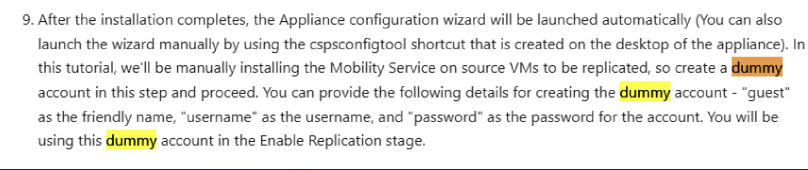

    In case of agent-based migration, you can skip assessment part since, it is a DC so you can directly migrate to recommended SKU in Azure and directly install mobility agent on source server and register it with replication appliance. In this scenario, you just need to create a dummy account.
    Refer to the doc here - Migrate machines as physical server to Azure with Azure Migrate. - Azure Migrate | Microsoft Learn
