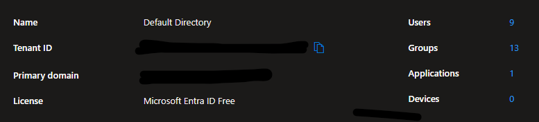

It seems the trial offerings changed recently, you used to have Enterprise Mobility + Security E5 and Entra ID P2 options to activate a trial. Additionally, it seems the process has changed.
When I log into a newly created pay-as-you-go tenant, browse to Licensing > All Products, and select try/buy, and then the P2 option, I am routed to a form that tries to create a new tenant.
That activation button activated the license from within the same dialog.
Is anyone else seeing this?

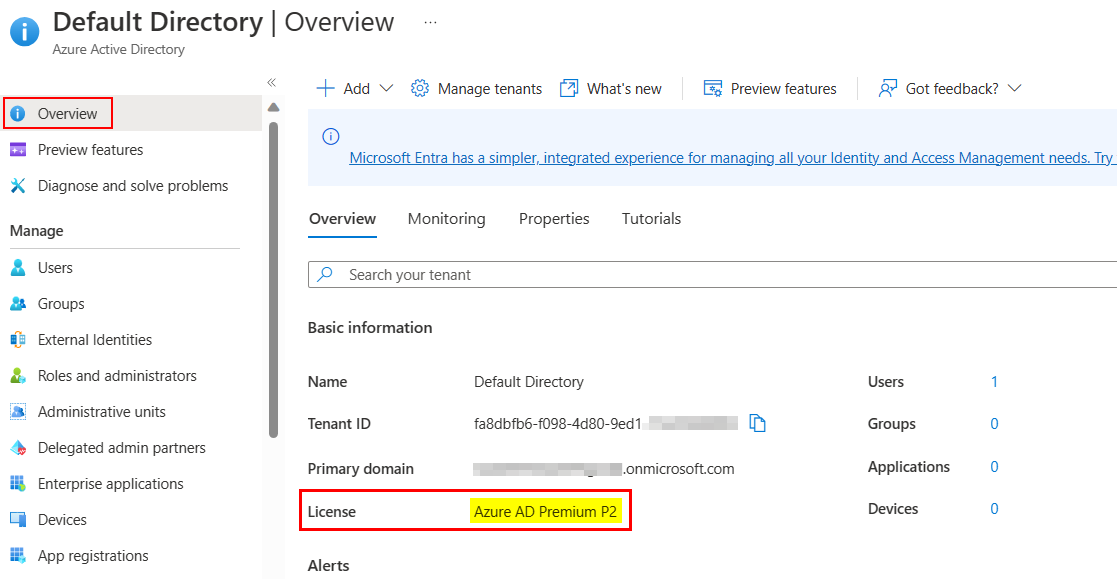

    I tested this on two tenants:
    • If I am trying on a tenant with no other Microsoft service trial, After selecting Get a free trial, click on Activate .
    • When I selected Activate, Azure AD Premium P2 license activated successfully as below:

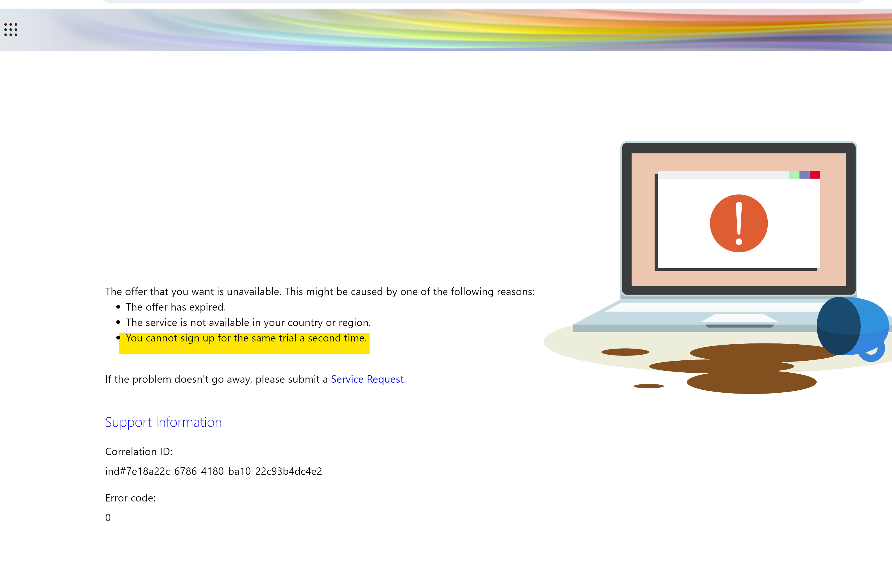

    However, when I try on a tenant already holding Microsoft Entra service trial, I am not able to activate it and ask me to create a new tenant.
    Microsoft Entra ID P2 free trail are limited to one free trial per tenant, if you have already activated the Microsoft Entra ID P2 free trial in past it will not allow you activate again.
