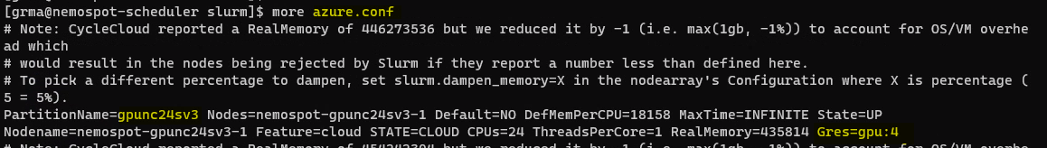

The Azure Slurm config seems to detect and configure the GPU enabled VMs:

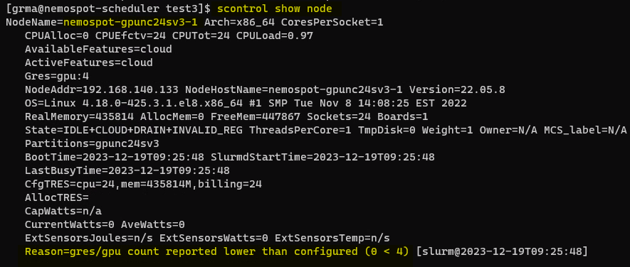

But, the Slurm node is showing as invalid "as the GPU count reported is less (0) than the (4) that is configured":

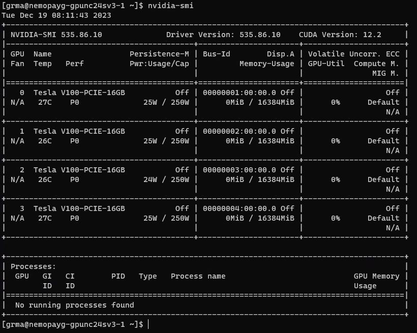

The GPU nodes are built from the Azure HPC AlmaLinux8 image, and when I login to them, the NVIDIA driver is installed and reporting the 4x GPU's:

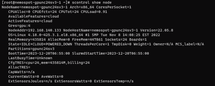

    Once the cluster template was fixed and new cluster built, I just had to ensure that my slurm job runit script had the following option in it so that there were GPUs available to my job
    ## Specify the number of GPUs for the task
    #SBATCH --gres=gpu:4
    Then, the GPU nodes would initialise correctly in Slurm and I could then run jobs against the GPUs.
