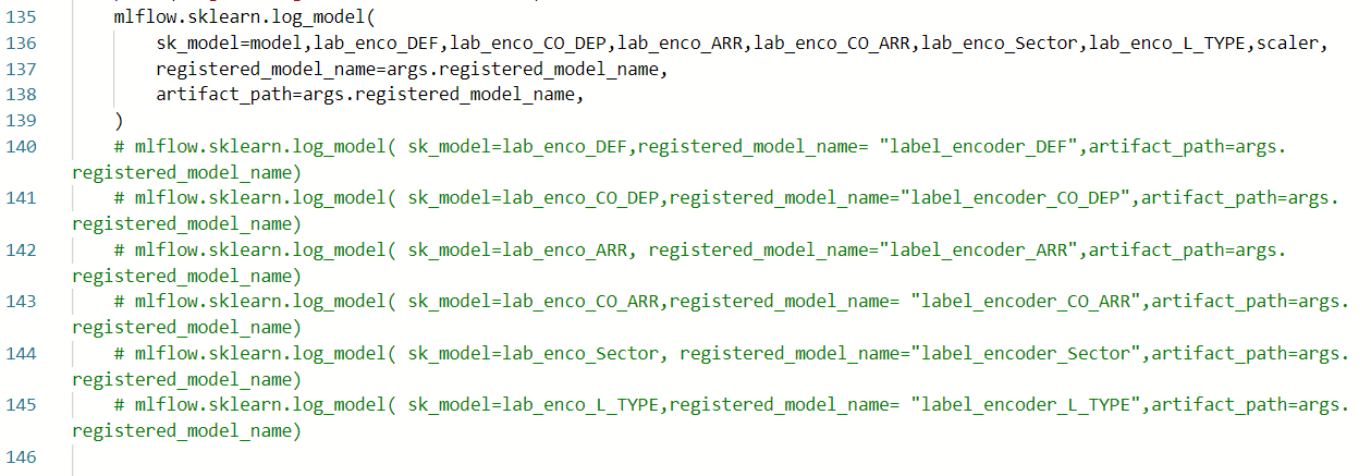

I am training a xgboost model with mlflow. In the preprocessing part i am using label encoder and min max scaler. I should log and register these encoder and scaler objects just like model.(to be able to use them in score.py in the prediction part). However i couldnt register all of them in the same artifact folder. I know that i should have one model (including xgboost model itself,encoder and scaler) in the azure ml models section and pass it into ManagedOnlineDeployment function.

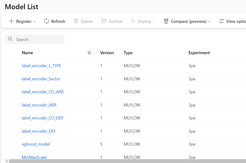

I am adding the ss of the code i am trying as well as its output in the models section.modellist
So, how can i register encoder, scaler and xgbregressor objects at once in the same directory ?

    To register all of these objects in the same artifact folder, you can use the mlflow.pyfunc.log_model() method. This method logs a Python model as an MLflow artifact for the current run. You can pass the encoder, scaler, and XGBoost model objects to the MyModel class constructor and then pass the instance of this class to the python_model parameter of the mlflow.pyfunc.log_model() method.
