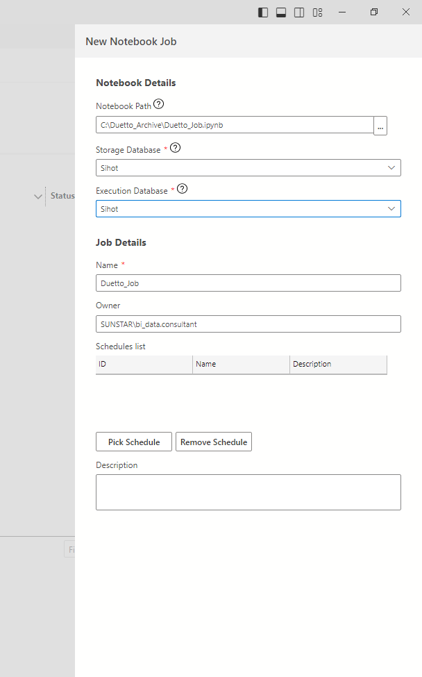

I am trying to schedule a Python notebook by creating a job Using an SQL Server agent but when I try to execute this it gives me the following error.
12/21/2023 10:05:00,Duetto_Job,Error,1,SUN-SQL02\BI_SIHOT,Duetto_Job,Exec-Notebook,,Executed as user: NT Service\SQLAgent$BI_SIHOT. The job script encountered the following errors. These errors did not stop the script: A job step received an error at line 6 in a PowerShell script. The corresponding line is '$sqlResult = Invoke-Sqlcmd -Query $JSONTable -Database $TargetDatabase -MaxCharLength 2147483647 '. Correct the script and reschedule the job. The error information returned by PowerShell is: 'A network-related or instance-specific error occurred while establishing a connection to SQL Server. The server was not found or was not accessible. Verify that the instance name is correct and that SQL Server is configured to allow remote connections. (provider: Named Pipes Provider<c/> error: 40 - Could not open a connection to SQL Server) The system cannot find the file specified ' A job step received an error at line 6 in a PowerShell script. The corresponding line is '$sqlResult = Invoke-Sqlcmd -Query $JSONTable -Database $TargetDatabase -MaxCharLength 2147483647 '. Correct the script and reschedule the job. The error information returned by PowerShell is: ' '. Process Exit Code -1. The step failed.,00:00:17,0,0,,,,0
But when I run the same notebook manually, it works fine. Help me please

    The error that you are receiving is from the Agent Job Step 'Exec Notebook' which you can find by editing the Agent Notebook Job in ADS and then the Job Step. My feeling is that it is not correctly locating the instance.

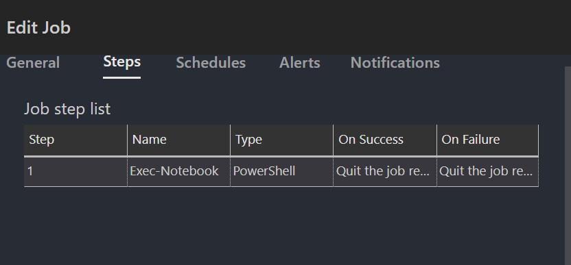

    click in the job step and press edit

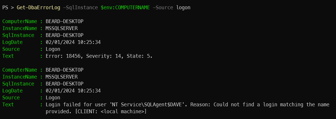

    The problem is that in this code there is no value set for the Invoke-SqlCmd cmdlet so it is using the hostname which is obviously no good when you have a named instance. I get login failures on my default instance for the named instance agent service account when I try to run a Notebook Agent Job on a named instance.

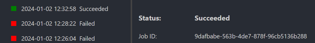

    This resolved this error for me
    Let me know how you get on

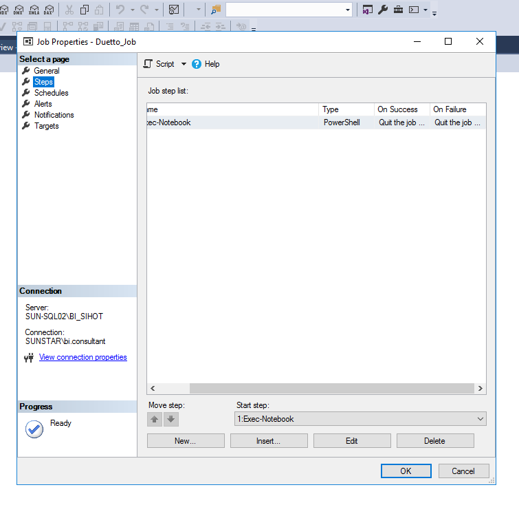

    Now that you have seen the PowerShell code, the fix should be quite apparent. Modify this line:
    To read:
    $sqlResult = Invoke-Sqlcmd -Query $JSONTable -Database $TargetDatabase -MaxCharLength 2147483647 -Server "SUN-SQL02\\BI_SIHOT"
    I'm a little uncertain whether the backslash should be doubled. If the above fails, try without doubling.
    However, I can't say that I feel that this is satisfactory. There should be a way to specify the server name when you create the jobs. Or the PowerShell script should be generated to include the server name - after all, it seems to know on which instance the job was created.
