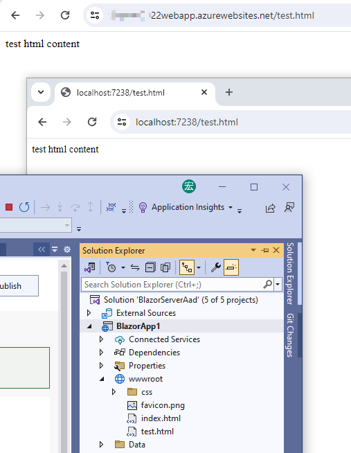

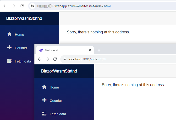

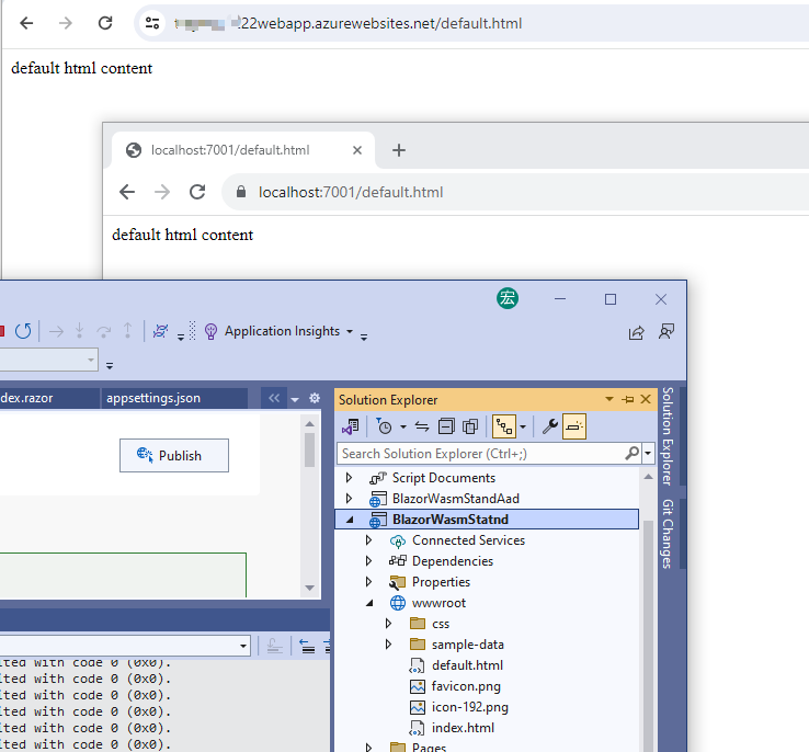

    Firstly, no matter you are having a blazor web assembly app or blazor server app, you all need to use the routing module inside it so that you could reach corresponding component. For the static html files inside the blazor app, per my testing with .net 7 blazor server and blazor stand-alone web assembly project, both of them are able to visit the html files inside wwwroot folder by default, the same after publishing to Azure. I noticed that you are using xxx.azurewebsites.net as the url so you are having an Azure web app but not the static web app(xxx.azurestaticapps.net). So I also created a .net 7 azure web app for testing.

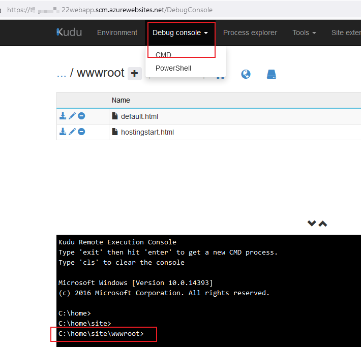

    The error message you got it says page can't be found on Microsoft Edge and on Chrome, I suggest you to checking in the kudu(xxx.scm.azurewebsites.net) to see if the default.html was existed inside the site/wwwroot path. If it's missing, we can manually add the file by clicking the "+" icon inside the screenshot below to add this html file, then the issue might disappear.
    Web assembly application test result.
    Test result with blazor server app.
