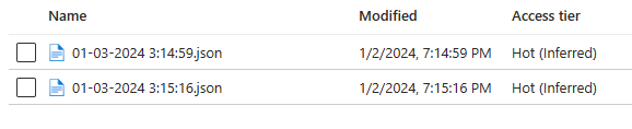

    • Resulting files created in Blob container:
    I hope the above helps & gets you unblocked. If you still hit the same issue, or have any follow-up questions, let me know in the comments below.
