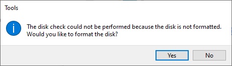

    Using file explorer as you suggest produces the result shown as follows:
    DefectiveUSBdrive-NTFSformat
    This is essentially the same thing that happens when the drive is first plugged in. In that, Windows seems to be saying there is NO file system. However, as mentioned chkdsk is able to tell that it is formatted as NTFS. According the description at the site you reference my chkdsk d: /f is in fact what your Powershell suggestion would do.
