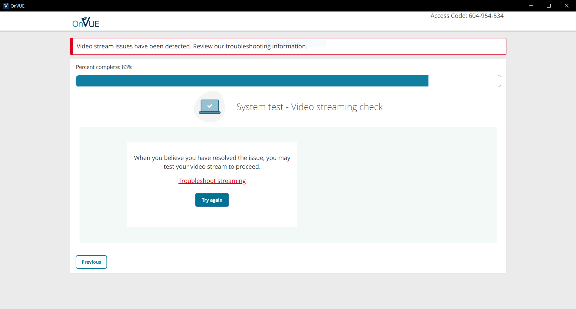

Hi, i am getting below error on OnVue
Video streaming connection results and requirements:
Your home/office network failed to connect to the required video streaming service.
The streaming connection requires that Wowza.com can be reached as well as a stable connection of at least 1mb upload and download speeds.
How to connect to our video streaming service:
  • Contact your network administrators and ensure the following:
    • Any network filtering software is disabled
      • WebRTC WebSocket connections must be allowed to ..cloud.wowza.com on TCP port 80, 443, 1935.
How can I fix this please?

  1. Jonathan 500 Reputation points
    2024-03-28T13:11:58.03+00:00
    If anyone else stumbles across this thread, it's the access code from PearsonVUE that causes this error. When you run a network test the access code authenticates, but then it will expire and give you a new code. The problem being that PearsonVUE gives you no information about this and you end up on a wild goose chase trying to figure out how to allow TCP access.
    Just go back to the registration email and follow the steps again. You'll see a new code when you go through the system test and then the network test will pass. Honestly, the amount of forums and Reddit threads that come up when you google the error is astounding. PearsonVUE is absolutely hopeless with their support and documentation, and so many people have missed their exam because of this issue too.

  2. Jason Haywood 55 Reputation points
    2024-04-05T14:27:16.3633333+00:00
    I saw this error happens when you're using yesterday's code. Turns out all you have to do is go back and click the Run System Test button again, it gives you a new code, I also redownloaded the file for good measure, ran just fine. Good luck!
