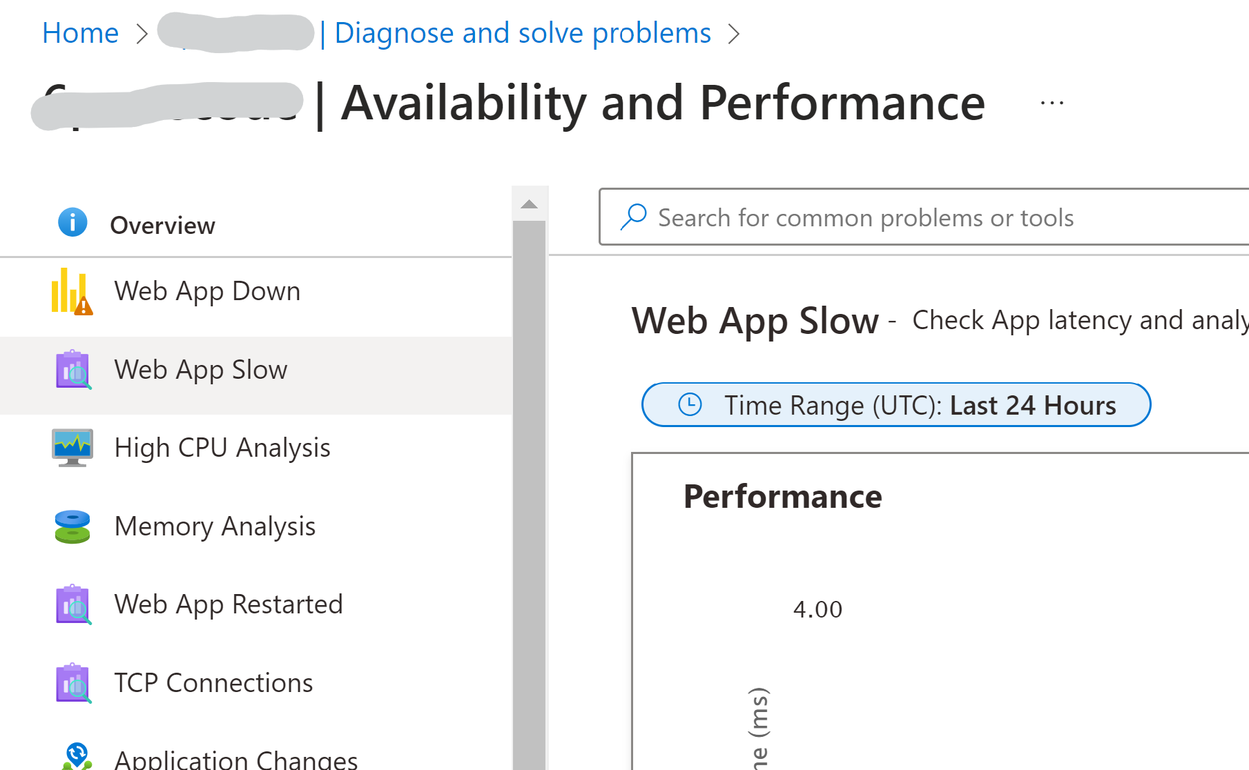

    @Jassim Al Rahma To add to further- You may also go diagnose and solve problems blade of your web app from Azure Portal > Availability and performance > Web App slow.

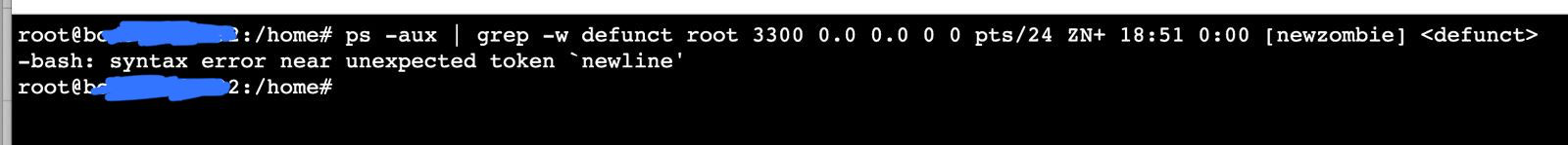

    1. SSH into your app container by going to https://sitename.scm.azurewebsites.net.

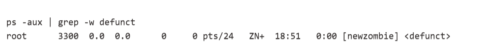

    2. Use ps to check for any <defunct> processes. Sample below. User's image

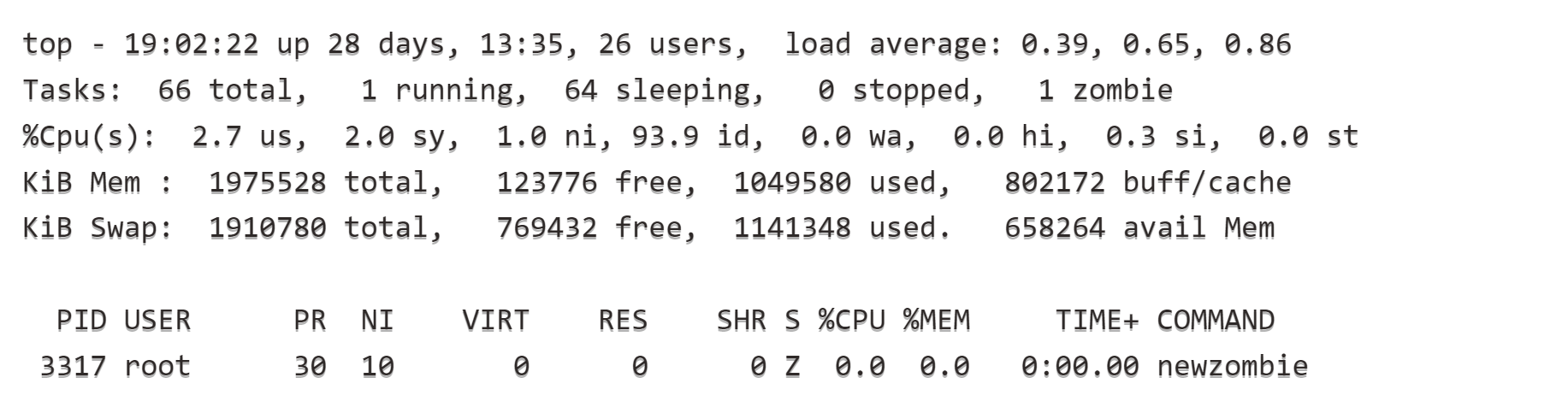

    3. Then use top to show any processes in a 'Z' state. Sample below (press 'o' and filter using 'S=Z')
    1. Once the process is identified, try restarting the process or consider restarting your site.
