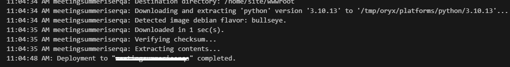

    1. Open Visual Studio Code and install the Azure Extension Pack.
    2. Log in to Visual Studio Code with your Azure account.
    3. Use the Azure App Service: Deploy to Web App command in Visual Studio Code and select your App Service name.
    4. Wait for deployment to be finished.
    5. Go to the Azure portal and update the Startup Command configuration for the App Service and set the value to run.sh. You can find this configuration inside App Service > Settings > Configurations > General settings.
    6. Wait for some seconds and visit the application URL. Congratulations! You have successfully deployed your Streamlit application to the Azure App Service.

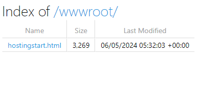

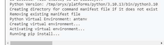

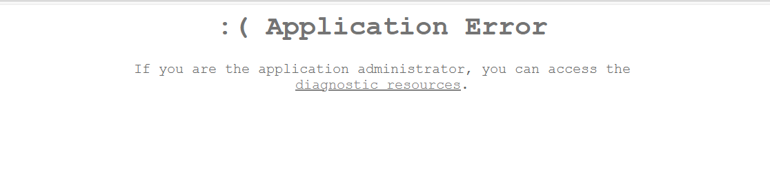

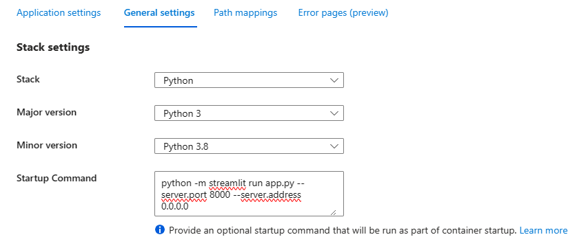

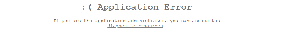

  3. VEK 15 Reputation points
    2024-03-30T22:45:58.1666667+00:00
    My app works fine locally. The issue is activating the app on B1 SKU for startup command. I entered run.sh on github REPO and removed the file on REPO to enter the entire command: python -m streamlit run app.py --server.port 8000 --server.address 0.0.0.0.
    I still get an application error on my _______.azurewebsite.net
    WHAT AM I DOING WRONG?

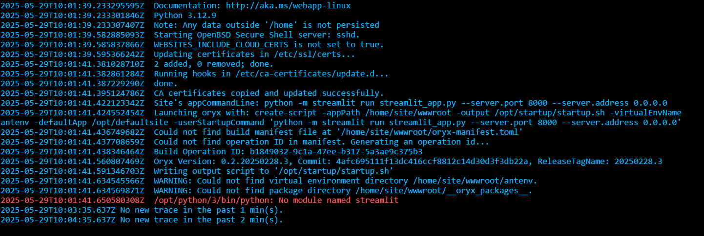

  5. Manish Kumar 5 Reputation points
    2024-07-04T15:47:56.3433333+00:00
    I am getting socket error in the browser
