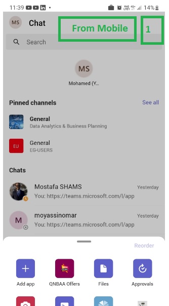

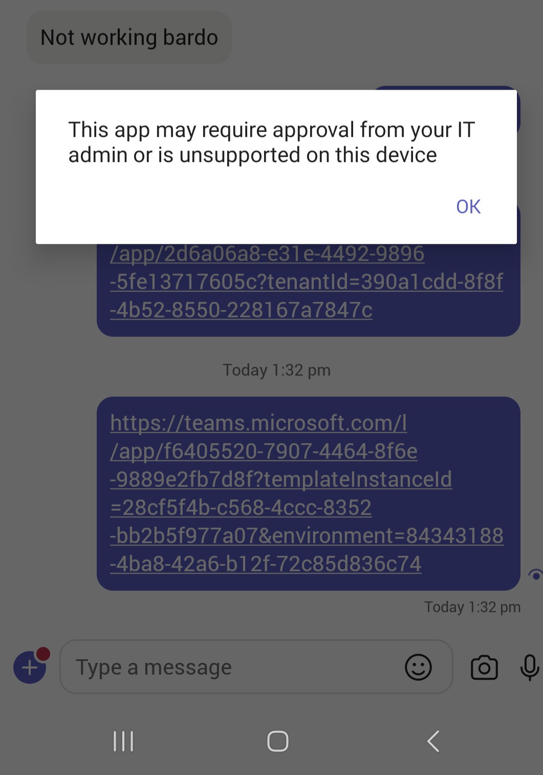

i have created power virtual agent chat bot and i could copy link of the bot and share this link with users.
-Users could open the bot using the link through MS teams web while the users who try to open the same bot link on MS teams Mobile app, these users got error "This app may require approval from IT admin or is unsupported on this device".
-i have tried android and iOS devices but got same error.
-i have uninstalled the mobile app then installed again but got same error.
-my MS teams android version is 1416/1.0.0.2023223901
-my MS teams android Calling version is 12023.44.01.9

Screenshot_20240102_171024_Teams

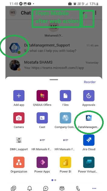

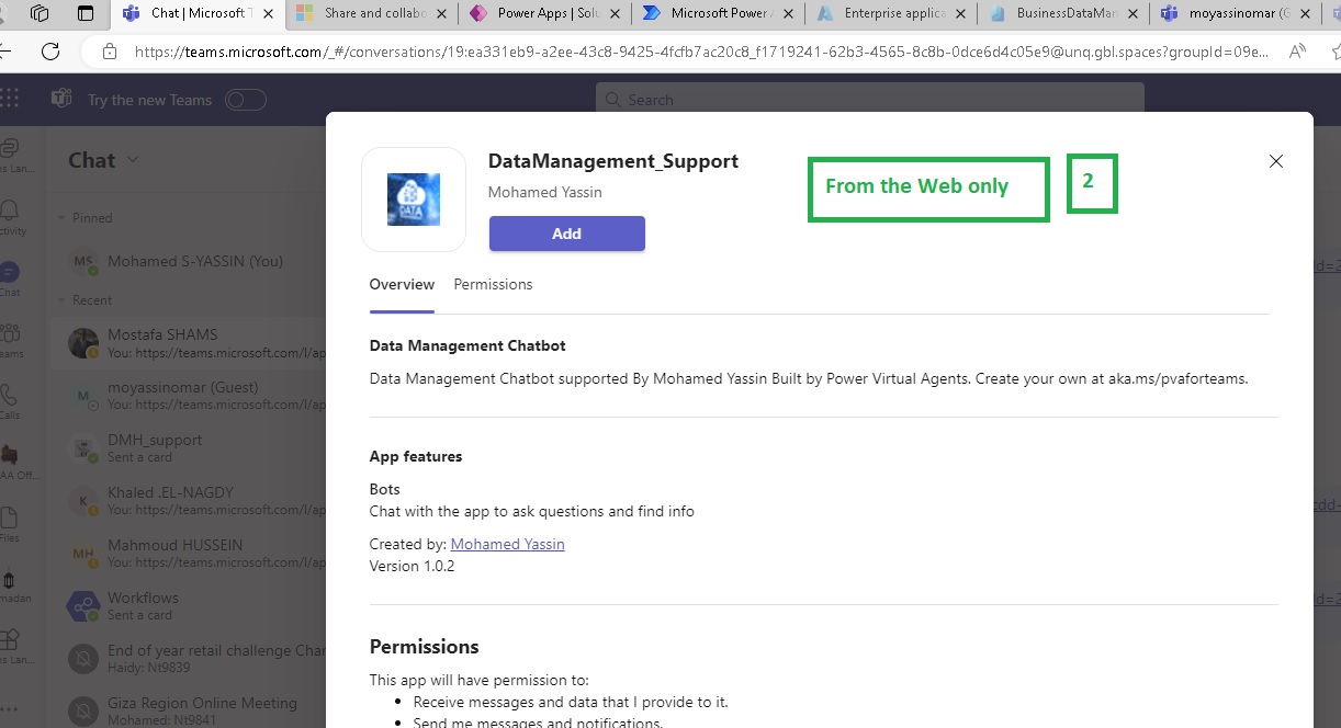

  2. 63083710 26 Reputation points
    2024-01-03T15:27:25.99+00:00
    Hello, thanks for your prompt feedback.

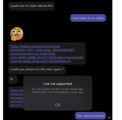

    -kindly note that iOs mobiles gives error "Link not supported" "You can't open this link on the mobile app. Please open it on the desktop or web app."
    -then when i installed the bot from my web app, then open the mobile app so i can now use the chat from my previous chats on the mobile app. But the users that have mobile app only, they could not install the bot for first time.
    -kindly could you give me details and screenshot for your mentioned option "conditional access policy on your mobile."Screenshot_20240102_171024_Teams_B
