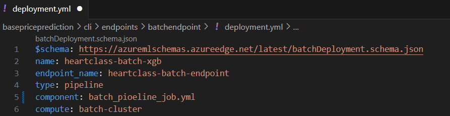

I am trying to create batch azure ml deployment and deployment.yml is below.
As per the batchDeployment schema, the allowed values for type is "model" or "pipeline". User's image
I am able to create the endpoint successfully.
But, when I run the batch-deployment create command as part of azure devops, I get the error for type as:
Batch deployment command in azure devops:
az ml batch-deployment create --endpoint heart-class-endpoint -f ./heartprediction/cli/endpoints/batchendpoint/deployment.yml --set-default
Error:
ERROR: The command failed with an unexpected error. Here is the traceback:
ERROR: Validation for BatchDeploymentSchema failed:
  "type": [
    "Value 'pipeline' passed is not in set ['component', 'model']"
  "component": [
    "Unknown field."
I even tried modifying the schema version in deployment.yml to the exact version 2.20.0 which is the latest version and the schema supports type= 'pipeline'.
https://azuremlschemasprod.azureedge.net/
https://azuremlschemasprod.azureedge.net/2.20.0/batchDeployment.schema.json
CLI version that I am using in CI pipeline is: azure-cli 2.55.0
What is the cause of the error? Is it due to the incorrect schema referenced at run time in devops?
