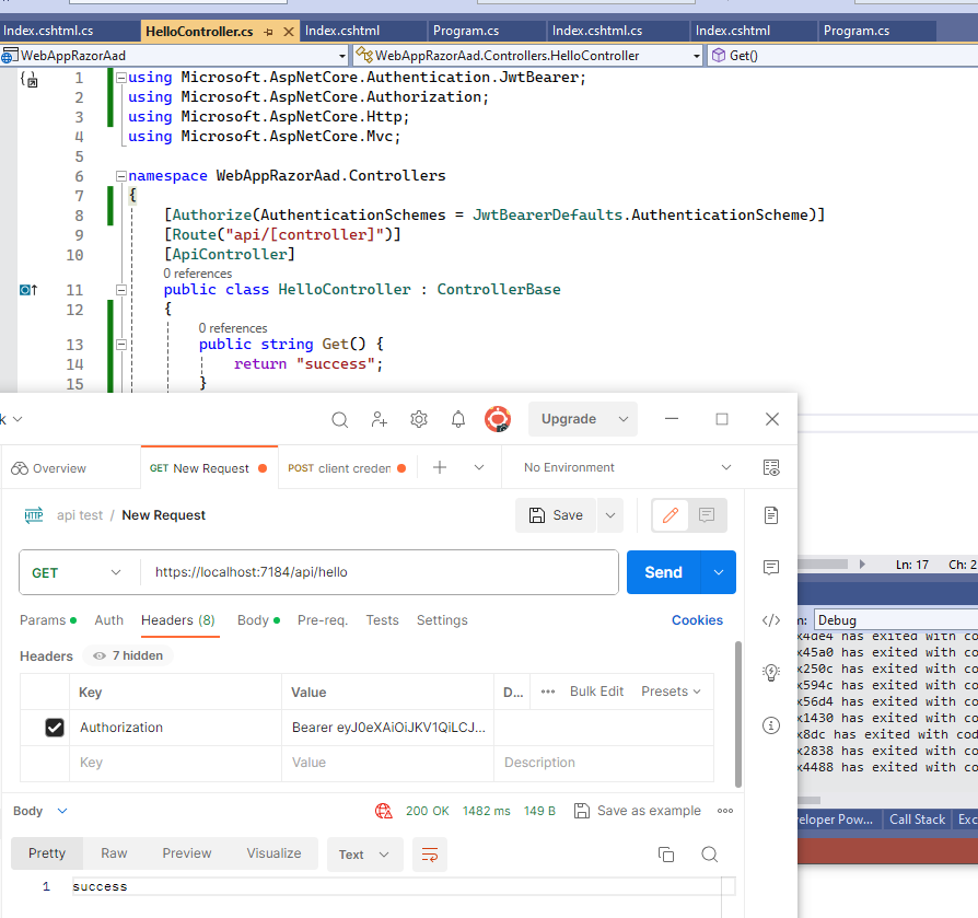

    Hello @Guisinger, Dan , I had a test with code below which worked well in my side.

    And for the API and the razor page, we need to use different auth scheme so that they will have different react for the react(401 for the API, auto redirect to sign in page for razor page)
    namespace WebAppRazorAad.Controllers
        [Authorize(AuthenticationSchemes = JwtBearerDefaults.AuthenticationScheme)]
        [Route("api/[controller]")]
        [ApiController]
        public class HelloController : ControllerBase
            public string Get() {
                return "success";
    using Microsoft.AspNetCore.Authentication.OpenIdConnect;
    using Microsoft.AspNetCore.Authorization;
    using Microsoft.AspNetCore.Mvc;
    using Microsoft.AspNetCore.Mvc.RazorPages;
    namespace WebAppRazorAad.Pages
        [Authorize(AuthenticationSchemes = OpenIdConnectDefaults.AuthenticationScheme)]
        public class IndexModel : PageModel
            private readonly ILogger<IndexModel> _logger;
            public IndexModel(ILogger<IndexModel> logger)
                _logger = logger;
            public void OnGet()

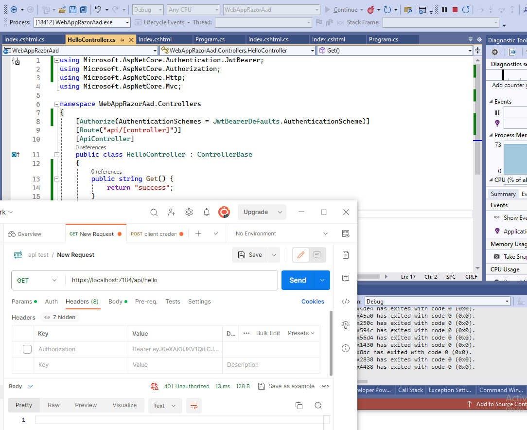

    I'm sure your issue is resulted from the builder.Services.AddAuthorization clause, if you comment it, requests to the pages which is not adding [Authorize] won't redirect to sign in page, but requests to the protected API would return 401.
