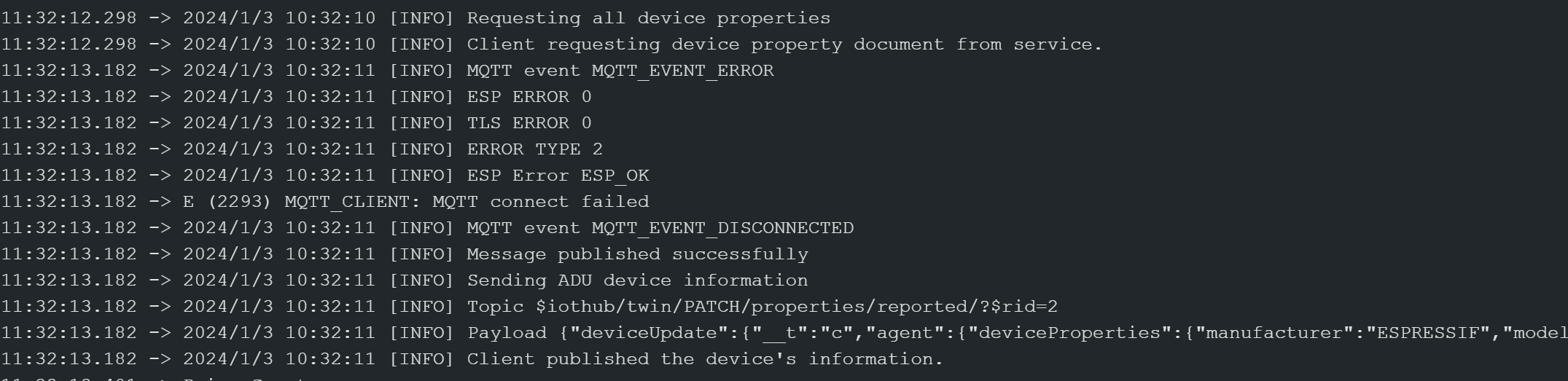

    Yes, I followed this manual to do a deployment. I connect my esp32 device and opening the serial monitor, when I do a deployment I see in the serial monitor that the update is downloading to the device (note: I only did a version upgrade of the package). The device is restarting after the update and then I'm seeing this in the serial monitor:

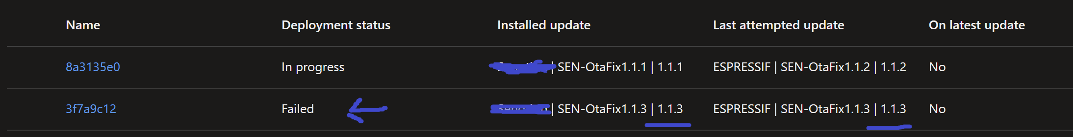

    In the 'Groups and Deployments' tab I do see that the device is on the latest update. When I open the ADUGroup I do see this:
    device list
    The installed update is version 1.1.3 from the Device Update and thats my latest version, but the column on latest update says 'No' and the deployment status is Failed.
