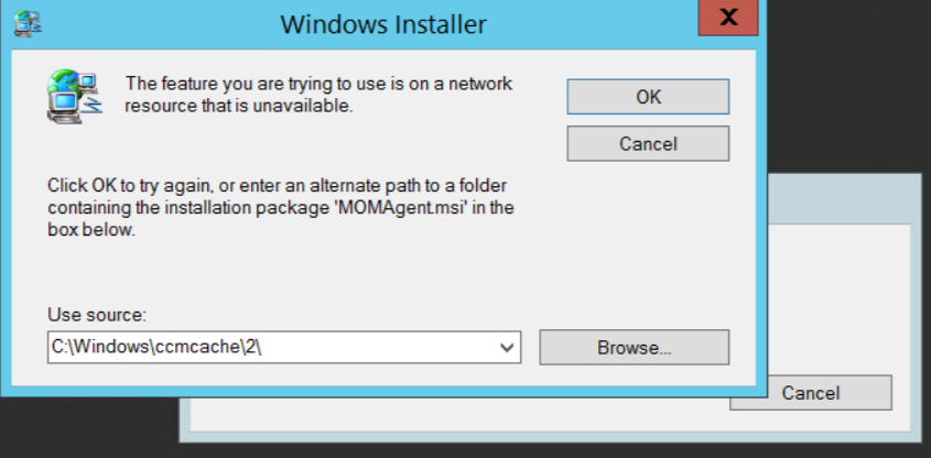

I'm unable to remove below SCOM agent version and received error. We have attempted to remove these version from SCCM and got failed for list of servers. I tried to locate the MOM agent.msi file for this version but no luck.
Could someone please tell me how to remove this agent from servers.
Agent Version : 8.0.13053.0
Error :

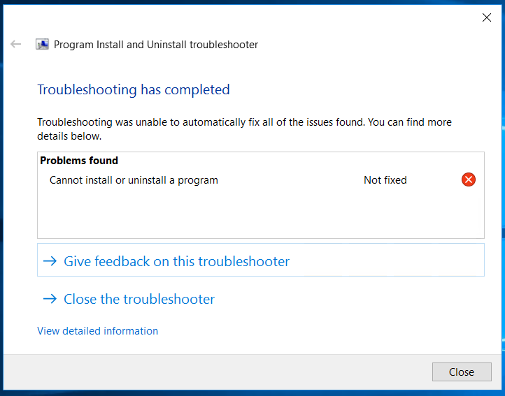

    1. Try this tool: Fix problems that block programs from being installed or removed
