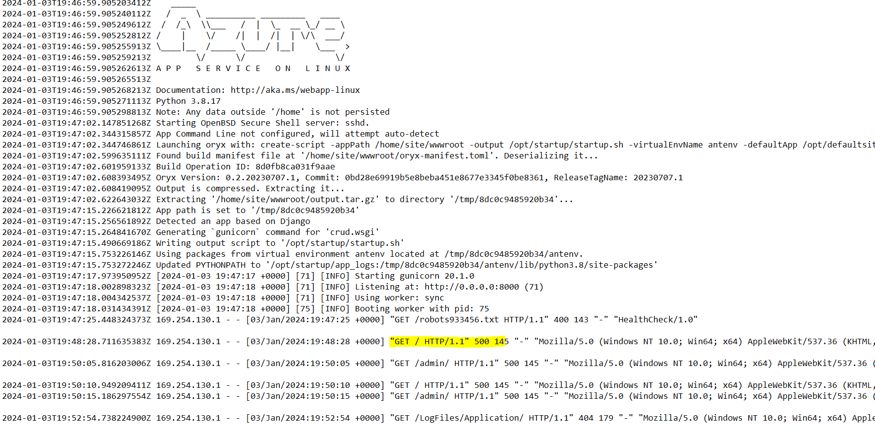

I am deploying a Django app on Azure App Services. When Debug = True the application works perfect. I can view my APIs, navigate to different pages, and create and delete records in my database.
However, when debug = False I get an internal server error 500. I don't see any warnings in my application logs or the log stream. I already tried to change the allowed_hosts, but this does not seem to be the cause of the problem.
I just disabled the STATICFILES_STORAGE setting in my deployment settings. When I now run the code in debug = False it works. However, I assume I will need whitenoise to handle my static files....
#STATICFILES_STORAGE = 'whitenoise.storage.CompressedManifestStaticFilesStorage'
What is the best way to solve this? Or can I simply leave out Staticfiles_storage without consequences?

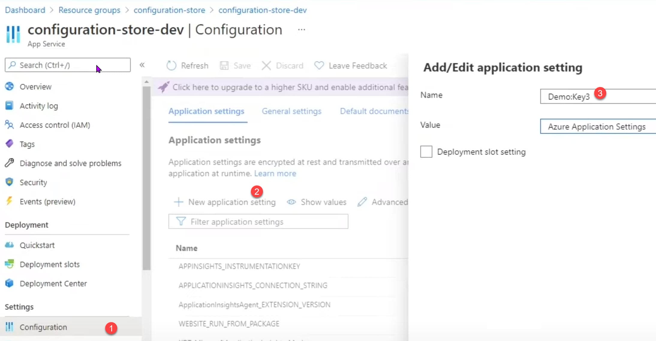

    Please verify that you have an Application Configuration Setting named
    WEBSITE_HOSTNAME
    and another MY_SECRET_KEY
    Sample
    configuration_azure_app_settings
    I hope this helps!
    Kindly mark the answer as Accepted and Upvote in case it helped!
    Regards
