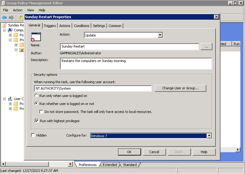

Here is my General tab for the scheduled GPO:
General screenshot

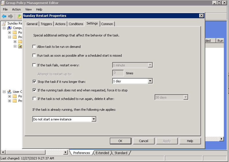

The task is scheduled to run every Sunday at midnight. I have the policy configured to wake the computer to run this task. My settings screenshot is provided below. Help is appreciated. Thank you.
Settings screenshot

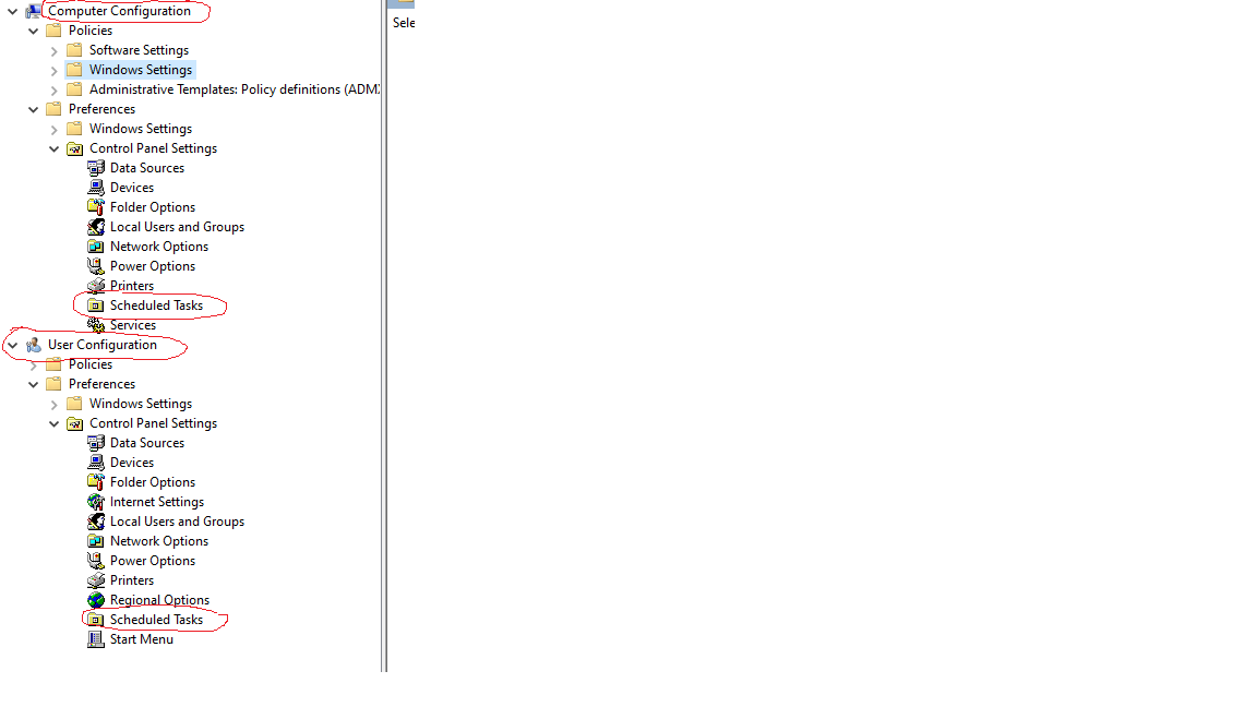

    I can see Scheduled Tasks under User Configuration and Computer Configuration, because you want to set computer to restart, I understand you have configured Scheduled Tasks under Computer Configuration.
    Untitled
    1.Create an OU and put all the machines you want to apply this Scheduled Tasks.
    2.Create GPO and link it to OU above.
    3.Edit this GPO. You can follow the steps as "Step 3: Create the Scheduled Reboot GPO" in the link below.
    Note: You do not need to set "3. Exclude Group (optional)" within "Step 3: Create the Scheduled Reboot GPO" in the link.
