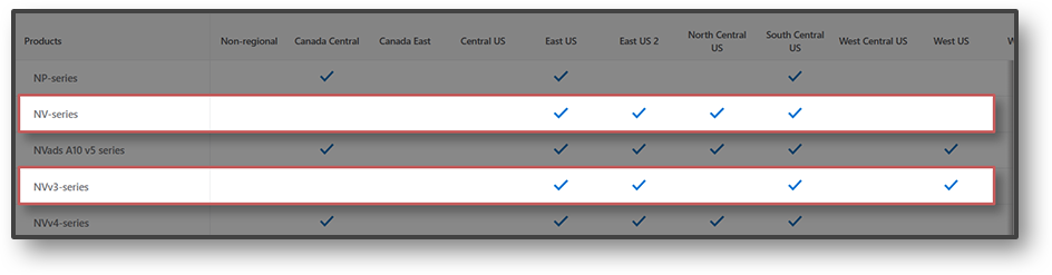

    The NP-series virtual machines are powered by Xilinx U250 FPGAs which uses the XOCL driver. This would explain why the NVIDIA and AMD drivers aren't working. I would recommend using a GPU accelerated VM family, like the NV-series and NVv3-series sizes which are the same VMs recommended for use with Maya. Still, it may be easier to use a different service for common tasks like cloud rendering. I've included some additional information below including some options specifically for Blender.

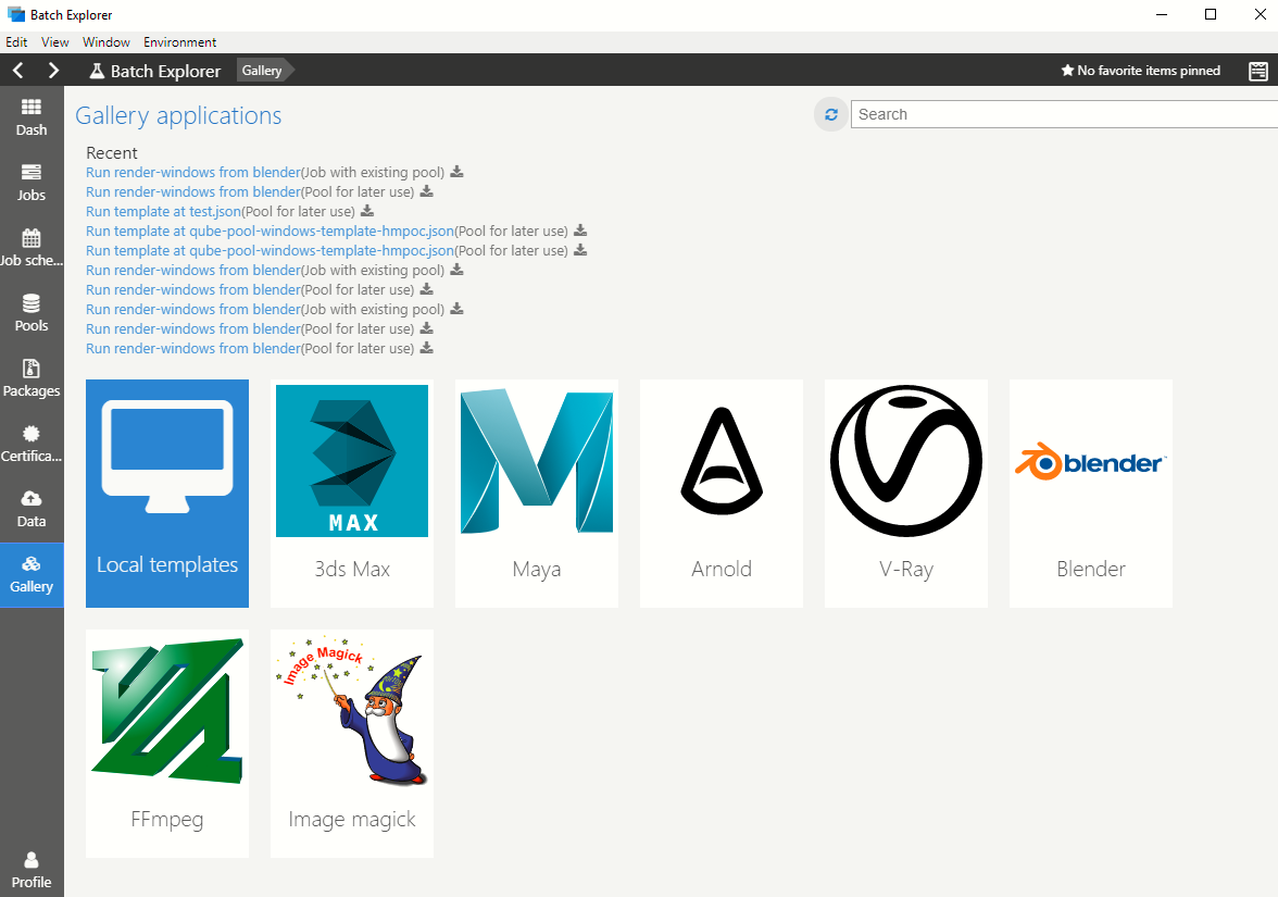

    How do I run Blender on an Azure VM?
    The simplest approach for the common task of cloud rendering is to use Azure Batch, which supports a variety of 3D software platforms including Blender as well as Autodesk 3ds Max and Autodesk Maya.
    You can find instructions for rendering using Azure in this series of documents:
    https://learn.microsoft.com/en-us/azure/batch/batch-rendering-service
    For additional information, you can check out this blog.Batch Explorer Gallery

    For full control of your VM, you can create something from the GPU family. I would recommend using the NV-series and NVv3-series sizes as mentioned above which are optimized and designed for remote visualization, streaming, gaming, encoding, and VDI scenarios using frameworks such as OpenGL and DirectX. These are the same VMs recommended for use with Maya.
