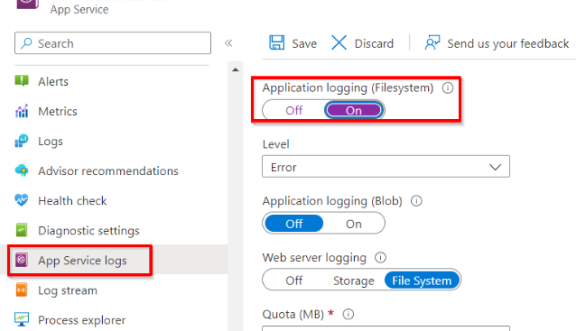

  1. Dillon Silzer 57,831 Reputation points Volunteer Moderator
    2024-01-09T05:05:02.71+00:00
    Hey Mohammed,
    Try opening your App Service > App Service logs > turn Application logging (Filesystem) to On.
    If this is helpful please accept answer.
