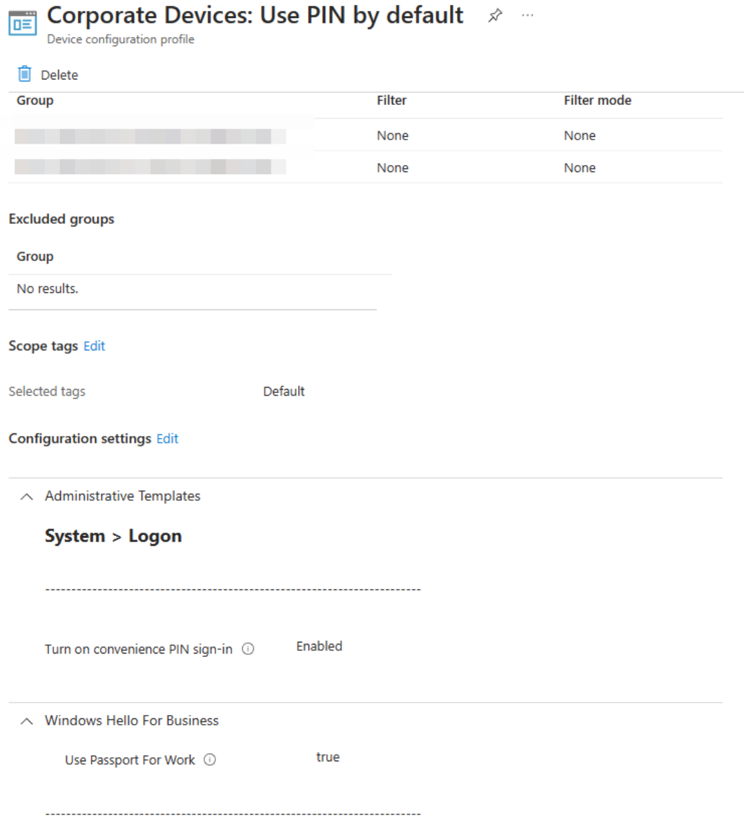

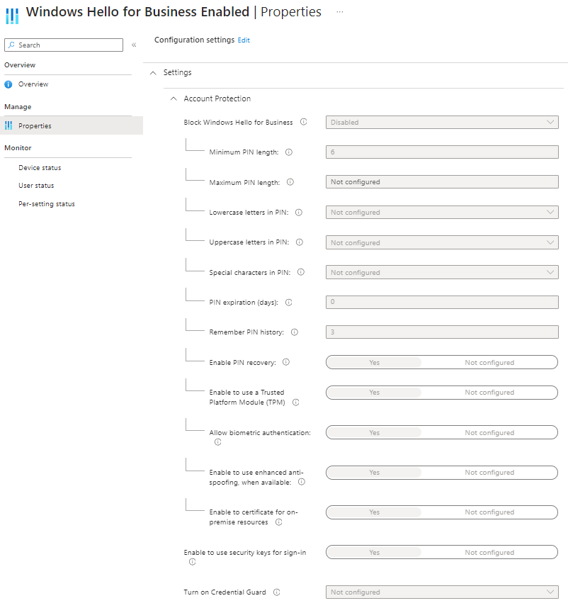

Hello,
We are deploying WHfB to Windows 10 Pro devices, using Intune.
Devices are compatible to have this setup but users aren't getting prompted for a PIN, after the biometric is set.
The laptops that are having this issue are different models and all up-to-date.
Can we get some guidance on why this is happening?
Kind regards

    How did we configure the configuration policy, Is it under Identity Protection? Could you get a screen shot of the detailed configuration?
