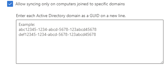

how to block SharePoint access from apps on unmanaged devices without affecting teams. When I select allow limited web-only access then it's blocking teams as well. How to only allow managed devices to sync sharepoint sites and only allow limited web-only access for unmanaged devices without affecting teams. Thanks.
