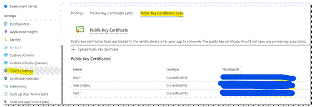

    Plan 1:
    Could you please confirm if you have downloaded and saved the full path certificates (root, intermediate, cert) locally, then upload the 3 certificate to Public Key Certificates in logic app standard as below.

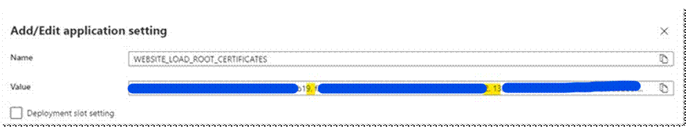

    Then we need to add 3 thumbprints on WEBSITE_LOAD_ROOT_CERTIFICATES key, as comma separated as below:
    The public key of the certificate must have been uploaded to Logic App as well. This is documented in the official documentation
