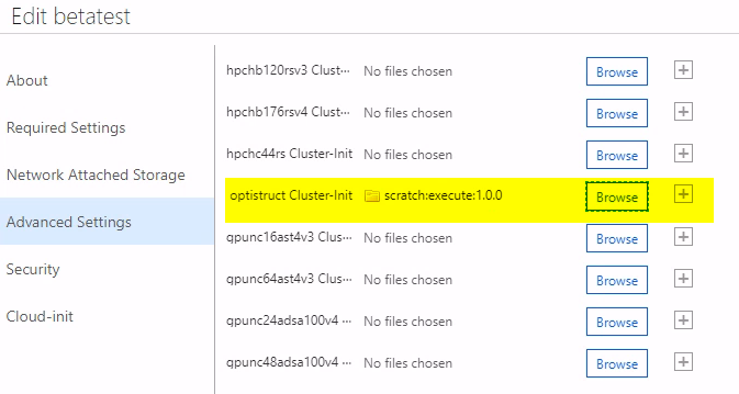

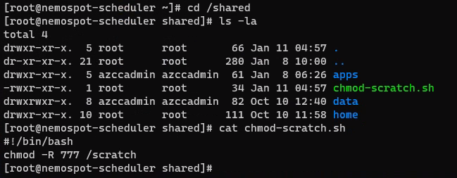

    Hi, I managed to get this working with a CycleCloud Cluster-Init Scipt which is run after the cluster is built. This script has to be created in project on the CycleCloud server and then uploaded to the locker (CycleCloud Storage account). Then, using the CycleCloud UI, you edit the cluster config and in the advanced setttings section select the cluster-init script for the node type in question. To create the script and upload it to the locker:
    $ cyclecloud project init scratch
    $ cd scratch/
    $ cyclecloud project add_spec execute
    $ vi specs/execute/cluster-init/scripts/000_install.sh
    #!/bin/sh
    chmod -R 777 /scratch
    [ricadmin@azu-nemo-srv ~]$ cyclecloud project upload
    Then, go to the CycleCloud UI and select to edit the cluster and add the cluster-init script: User's image
