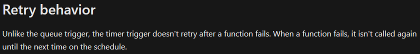

    UPDATE 2/7/24: If the function execution does not complete the schedule will not be updated so the timer will be seen as past due. The following note in the TimerTrigger doc is still valid in this case:
