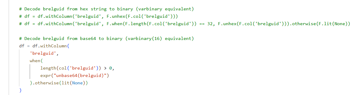

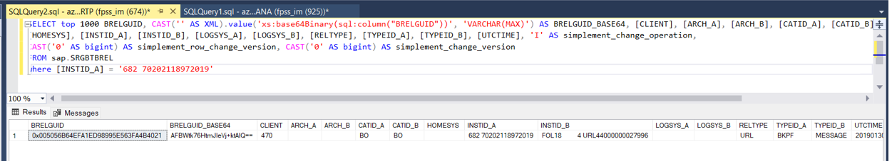

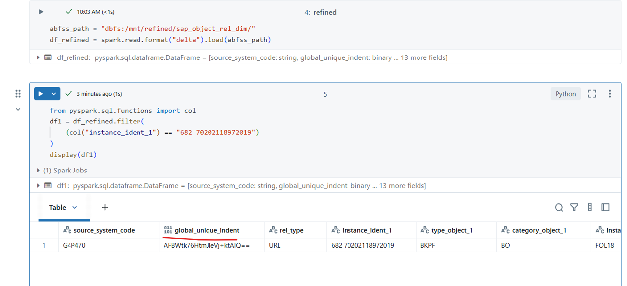

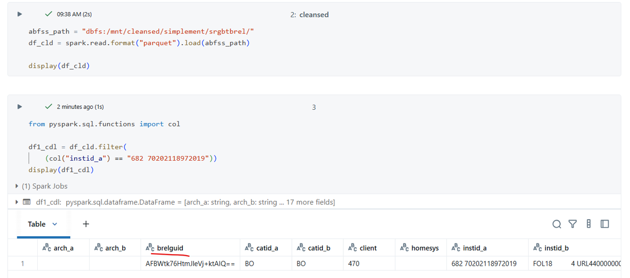

  2. Ravi Ankalagi 0 Reputation points
    2025-10-30T03:15:12.8166667+00:00
    I am also facing the same issue, in SQL server
    When I decode it in the databricks pyspark, I am not getting the correct values as in SQL server. I am using base64binary for encode/decode.
    Decode in refined layer using
    I have tried both HEX/base64binary approach. nothing is giving me the same values as that in sql server after decoding.
    Any other solutions, that we can try to get the same values in Azure blob using databricks pyspark.
