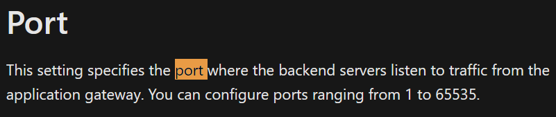

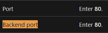

    You may introduce a Load Balancer or Proxy service such as Azure Load Balancer, Application gateway in front of your server.
    • This way, the Load Balancer would listen on Port 80 or 443
    • And would transfer the traffic to the server on Port 8069 (which is marked from client browsers)
    • i.e., Clients will not see the port number in the URL.
