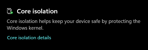

  5. Holger Winnemoeller 0 Reputation points
    2025-04-01T22:17:29.21+00:00
    OK, I had the same issue.. And what finally did it was this:
    In Windows-Security > Device Security > Core Isolation
    Core Isolation was disabled due to incompatible drivers.
    I had to uninstall all the relevant Programs/Drivers to be able to enable Core Isolation{50440CF3-1624-4D8A-BAA2-036498A79C2C}
    Once Core Isolation was enabled (and all the other things that are mentioned above, like BIOS settings), then I was able to satisfy the VSM policy and I could install virtualization services without constant Boot failures.
