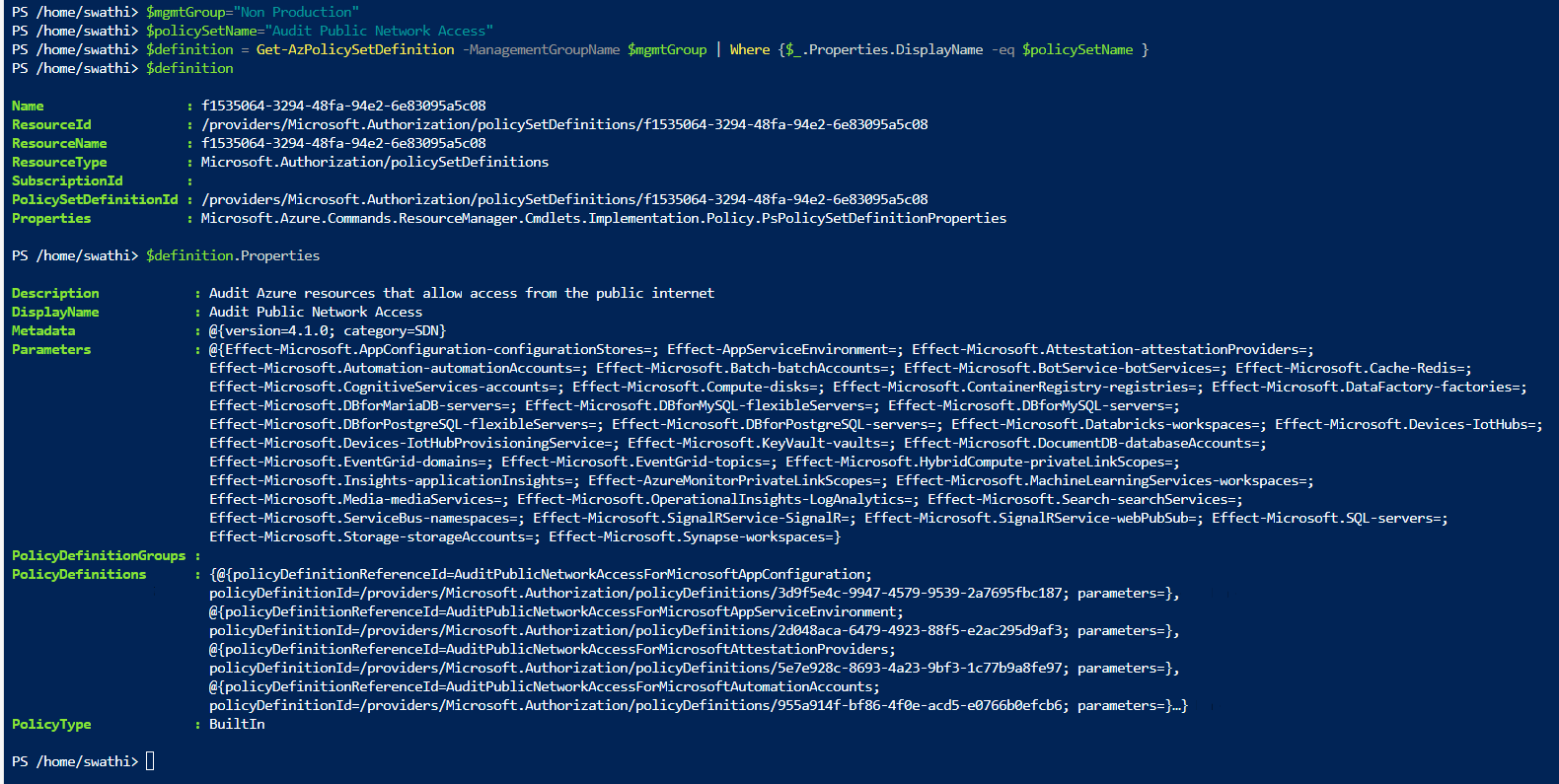

    MrFlinstone Thanks for reaching out. The process you are following is correct. However, I will share an example of how I retrieved the mentioned information in my environment for your reference.
    In my example, I am retrieving the Policy Initiative "Enable Azure Monitor for VMSS with Azure Monitoring Agent(AMA)".
    $mgmtGroup="Non Production"                                                                                                              $policySetName="Audit Public Network Access"
    $definition = Get-AzPolicySetDefinition -ManagementGroupName $mgmtGroup | Where {$_.Properties.DisplayName -eq $policySetName }
    You can the internal name of the policy set definition using below command which is what you have been using.
    $policySetName } | Select-Object Name
    To display all the values of property object within policy set definition, you can either follow the process shown in above screenshot or execute below command.
    ( Get-AzPolicySetDefinition -ManagementGroupName $mgmtGroup | Where {$_.Properties.DisplayName -eq $policySetName }).Properties

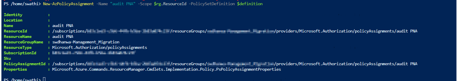

    Regarding second error where you are prompted with Name not found , kindly share further information on the error by adding -debug property to command as I wasn't able to reproduce the error you are facing even though I am using similar commands as you.
    $rg = Get-AzResourceGroup -Name "amkiyu"
    New-AzPolicyAssignment -Name "audit PNA" -Scope $rg.ResourceId -PolicySetDefinition $definition
