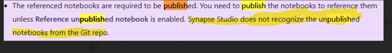

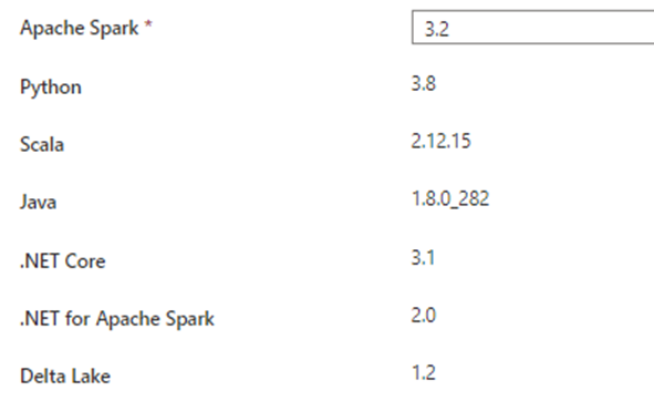

All referenced notebooks are published and enabled unpublished notebook references. Been working all this while, and just today gives this error. Configuration shown in image.

    Thanks for the above details. Can you please double check if the referenced notebook is published?
    from the below synapse feedback items, Synapse doesn’t support unpublished notebook reference in pipeline scenarios
    1. If the notebook is being pulled from Git repo, if yes then the behavior is expected.
    2. Please refer to table in [How to use Synapse notebooks - Azure Synapse Analytics | Microsoft Learn] https://learn.microsoft.com/en-us/azure/synapse-analytics/spark/apache-spark-development-using-notebooks#reference-unpublished-notebook and see if you are meeting the conditions
