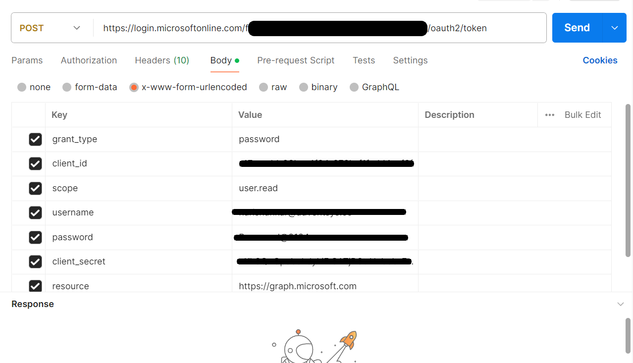

Is there any graph API for the MFA (multifactor Authentication)?. Currently i am using this api for username and password for authentication purpose. https://login.microsoftonline.com/{tenant-ID}/oauth2/token(Ref Figure)API
I got this error for using this API - "error_description": "AADSTS50076: Due to a configuration change made by your administrator, or because you moved to a new location, you must use multi-factor authentication to access '00000003-0000-0000-c000-000000000000'." Is there any alternate api for the accounts that have MFA enabled? or any alternate solution. If any alternate api is available, please provide the required URL and the body content as shown in the above image
P.S - This API worked for the ID's that does not have MFA enabled.
Thank You

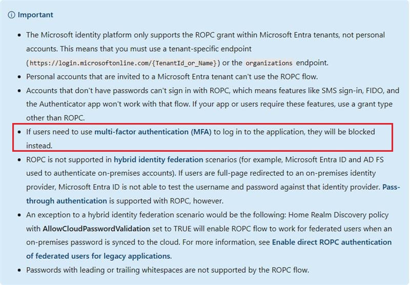

    The ROPC flow is a silent login flow that authenticates by hardcoding username/password and will be blocked at login if your users have MFA enabled.
    675c491d-ce54-4b65-bd38-8724e4c11275
    The flow suitable for authenticating users who have enabled MFA is auth code flow, because the auth code flow is an interactive login flow, which logs in users through browser interaction.
    Hope this helps.
