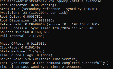

Hello everyone, I don't quite understand the behaviour of the root dispersion of Windows NTP servers. I would like to set up a network of Windows-based and non-Windows-based devices. I would like to define a computer with Windows 10 (Enterprise LTSC version 1809) as the NTP server that is to supply non-Windows-based devices with Chronyd time service with a synchronised time. However, the computer is only a secondary reference and receives its time as a client from an external Windows NTP server. Unfortunately, this secondary server receives the time with too high a root dispersion (~10s fluctuation). According to the manufacturer, the devices with Chronyd time service that are supposed to connect to this time server only accept a root dispersion of less than 3s. How does the root dispersion generally behave in such an architecture? Is the root dispersion passed through over several levels or does it add up over several levels? Is it possible to forward the root dispersion on the secondary server with a value less than 3s without adjusting the root dispersion of the primary server? Maybe you can enlighten me about the behaviour or have an idea how I could implement this scenario. Best regards Tobias

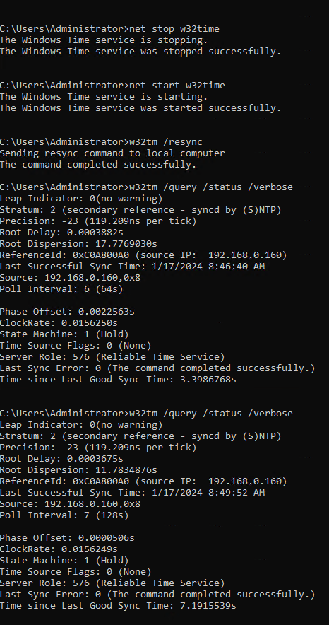

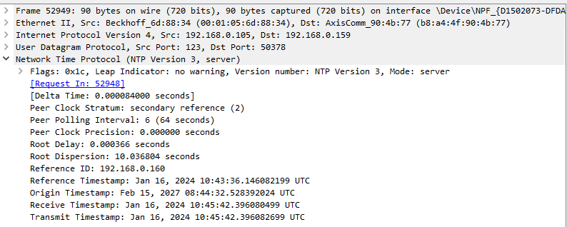

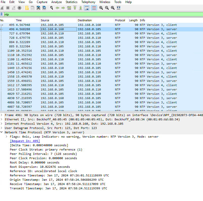

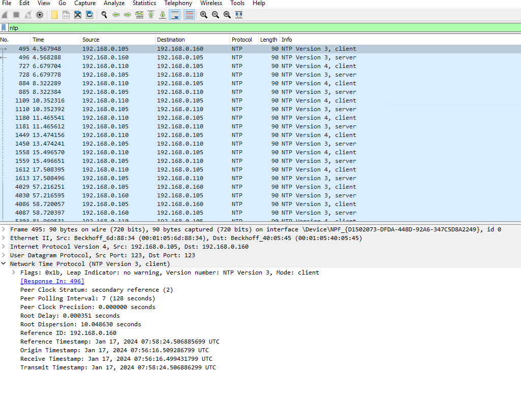

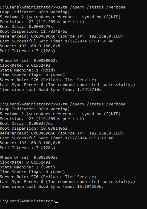

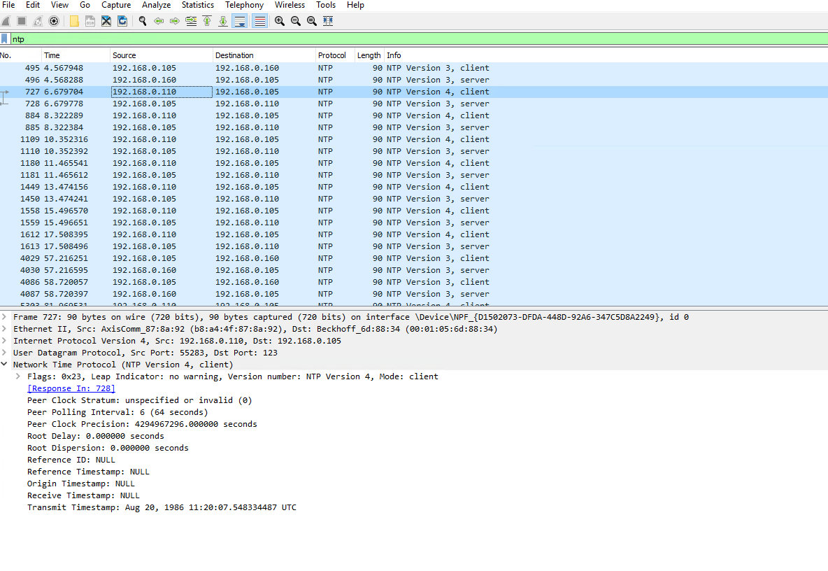

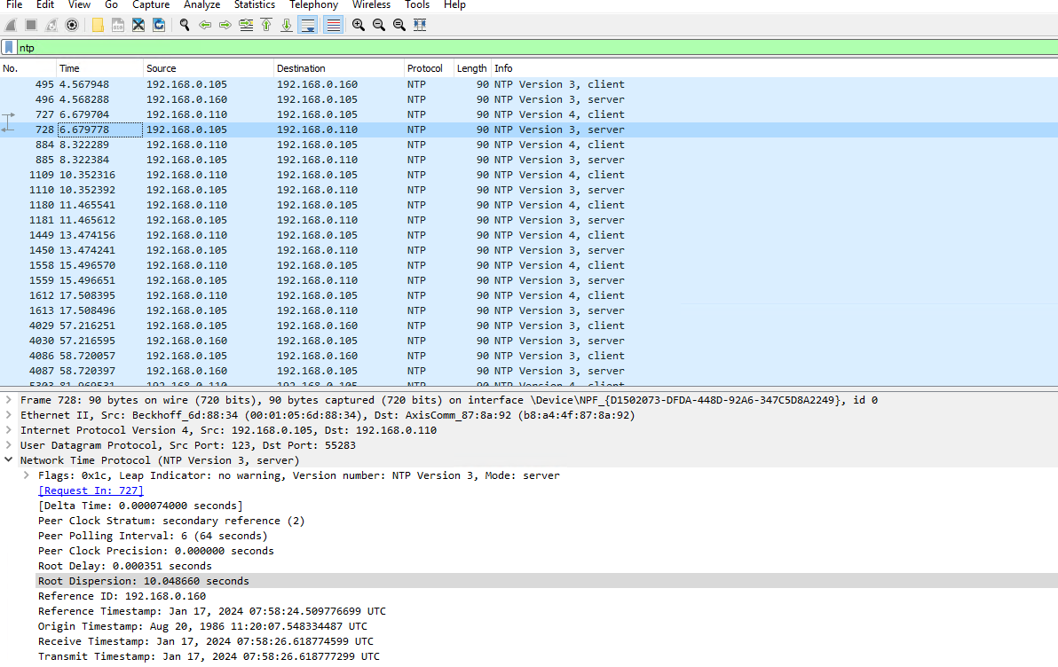

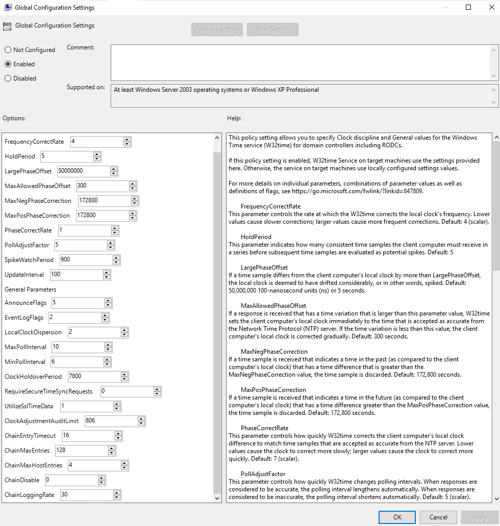

    I think the architecture with the intermediate server is what I already tried. But this didnt work for me. For test purposes I set up a primary NTP server who runs with local CMOS time. He is the Stratum 1 with local clock dispersion of 10. (IP 192.168.0.160) Then I set up a second NTP client who synchronizes its time with the primary server (IP 192.168.0.105) Pic1.png After that the client should also run as NTP server who publishes its time (with clock dispersion of 2) to the Chronyd clients. Here is the configuration of this secondary server. Pic2.png After that I connected one Chronyd device into the network and defined the secondary server as its time source. I monitored the NTP network traffic with Wireshark between the secondary server and the Chronyd client (192.168.0.159) and it seems like the secondary server publishes its synchronized time also with a clock dispersion of ~10. Pic3.png Maybe I did something wrong in the configuration of the second NTP server or something else. The Chronyd client does not accept the time source of the secondary reference.

    I can provide a comprehensive step-by-step guide to fix the issue with your NTP server reporting the expected Root Dispersion value to the Chronyd clients. Here's what we need to know first:
    1. Verify LocalClockDispersion setting:
    • Please confirm the exact value of the LocalClockDispersion key in the registry at HKEY_LOCAL_MACHINE\SYSTEM\CurrentControlSet\Services\W32Time\Parameters.
    • Ensure it's set to 2. If it's not, set it to 2 and restart the Windows Time service with net stop w32time followed by net start w32time.
    2. Recapture NTP traffic:
    • Use Wireshark to capture NTP traffic again after setting or verifying the LocalClockDispersion value. Focus on packets from the secondary server (192.168.0.105) to the Chronyd client (192.168.0.159).
    3. Analyze results:
    • Check the Root Dispersion field in the captured packets. If it's still around 10, proceed to the next steps.
    4. Further troubleshooting:
    • If the problem persists, try these advanced steps:
      • Set LocalClockDispersion temporarily to a slightly higher value (e.g., 3 or 4) and then back to 2, sometimes this helps registry changes take effect.
        • Review other relevant registry keys related to NTP server configuration in HKEY_LOCAL_MACHINE\SYSTEM\CurrentControlSet\Services\W32Time\Parameters. Look for any conflicting settings or inconsistencies.
          • Consider using a different NTP server software on the secondary server to see if its dispersion handling differs.
            • Implement an intermediate server between the primary and secondary servers, configured to report a lower dispersion and act as a relay.
            5. Monitor and confirm success:
            • After trying any of these solutions, recapture NTP traffic and verify if the Root Dispersion reported by the secondary server has changed to the desired value of 2. If so, it indicates the issue is resolved.
