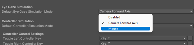

    Enable simulated eye tracking using mouse:
    • Click on the 'Input' tab in your MRTK configuration profile.
    • From there, navigate to 'Input Data Providers' -> 'Input Simulation Service'.
    • Clone the 'DefaultMixedRealityInputSimulationProfile' to make changes to it.
    • Select the ‘Mouse’ in the 'Default Eye Gaze Simulation Mode' setting. Picture1
