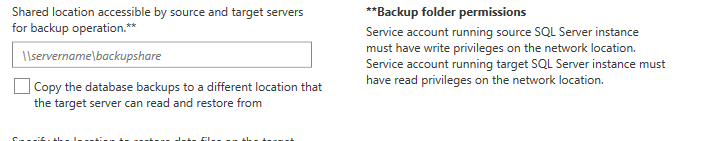

UseCase- I am performing Data migration between the two sql server using the Data Migration Assistant tool. i.e I am migrating the Data from sql server1 to sql server 2 Case works Fine- Data Migration using the DMA tool works fine when performing the migration from Sql Server 1 To same Sql server1
Case works Fine-Data Migration using the DMA tool works fine when performing the migration from Sql Server 2 To same Sql server2.

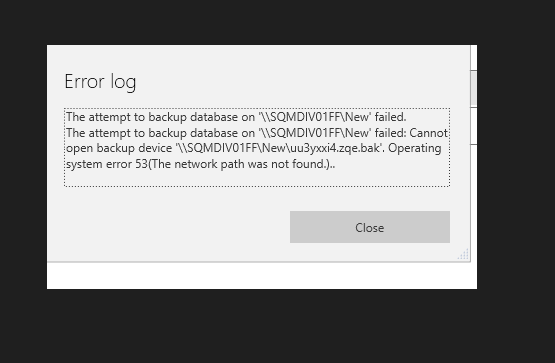

Question- When I migrate the data using the DMA tool from server1 to Server2 from the server2 location. i.e DMA tool is installed on the server2 location The data migration fails due to the below backup path.
Backup Path-\SQMDIV01FC\New gives the error, I have provisioned the read/write permissions to everyone for this path. Still i get an issue below.!! The screenshot from the DMA tool. User's image
The screenshot after performing the migration from the DMA tool.
Please help how to resolve the above issue. How to make the path which is readable my both the source and the target server
